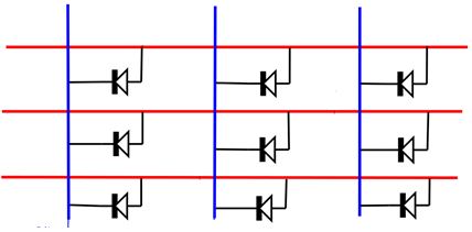

    I need the 256- channel multiplexer, to select one of the 256 sensor board channels. the block diagram of a 3*3 sensor array is shown bellow.
    A current in the range of nA should be selected and passed by the multiplexer switches. The voltage can be limited to 5 volt. The speed is not so critical. A clock in the range of KHz is good enough. but the leakage current must be bellow pA.

  • Hi Noushin,
    How many ADCs/MPs are you planning on using for the 256 sensor board channels? We don't have a 256:1 MUX, at 5V, with below pico-amps of leakage. We don’t have any Muxes that fit that as a single package. The best resolution I see to that is using smaller MUXes as building blocks. With our parts it seems that we could use 64 4:1 Muxes, followed by group of 8 8:1 Muxes, finally one 8:1 Mux. This requires 73.

  • Hi Jon,
    Thank you for your guidance. Then with the mentioned arrangement, can you introduce me for the lowest possible leakage current chips? I mean the leakage current when the switches are on. I need the accumulated leakage current in the 3 stages of MUXs to be in the range of pA.
    Thank you again.
  • Hi Noushin,
    Based on a 5V supply, the lowest leakage products in our portfolio are the TMUX1108 (8:1 MUX) and the TMUX1104 or TMUX1109 (4:1 MUX). I would recommend different variations of these depending on your layout or requirements. I would be wary that adding all these Muxes together could cause the total leakage to creep up to nA. Our TMUX11XX family is our lowest leakage family in low-voltage.
