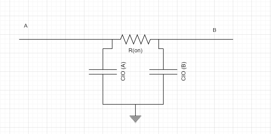

Are there models of P/N SN74CBTLV3257 and TMUX1574 for TINA-TI simulation? I only found IBIS models for these devices.

    Unfortunately we do not have TINA Models for these parts. We are currently in progress for a PSPICE model for the TMUX1574, but it is still in development.
    However, I can assist you in creating a simple model that can help capture either of these parts affect on the system design. Are there any concerns with these parts that I can help answer for you?

    I need to check the signal integrity of a 2.5V, 30MHz JTAG clock, which goes through the SN74CBTLV3257 then a voltage translator SN74AXC4T774. I found a TINA model for the voltage translation in one of the forum threads. Can I model the switch as a 5ohm resistor and a capacitor?

    Yes you should be able to model the channel of switch as a simple RC circuit. I have attached a basic circuit that you can use. For example Ron, with a VCC of 3V and input of 2.4V would produce a typical Ron of 10 Ohms, where CIO(A port) ~ 10.5pF and the CIO(B Port) ~ 5.5pF.
