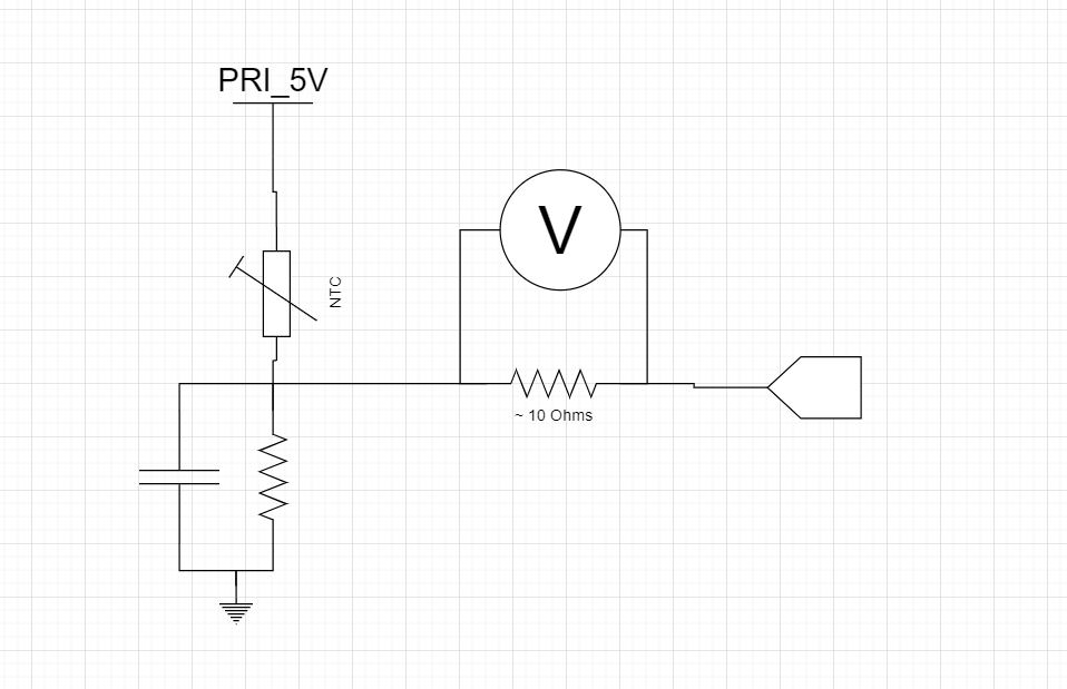

  • Hi Jason,
    I am sorry for the confusion!
    To start to narrow down the source of the problem the first thing is to disconnect the IC. Then measure the voltage drop to ground from the NTC resistor bridge, without the IC. If there are loading effects caused by the IC, they won't show up in this configuration, shown below:
    If the divider acts as expected the next test would be to implement the following circuit to see if the loading of the ADC is causing issues:
    We measure the drop across the 10 Ohm (or similarly sized resistor) to see if the ADC + resistance is causing any loading effects. Even though the ADC is supposed to be high impedance, I just want to make sure that it isn't causing any errors.
    For these tests it is important that they are carried out on the boards that are failing; if the problem is solved after removing the IC and running the above tests, then it is much more likely that the mux is the culprit behind the failure.
    Please let me know if you have any questions or concerns about the above tests.
