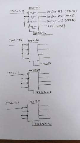

  • Hi Saminah,
    Actually, I need 3 channel for TMS,TDI,TDO,TCK signals.
    I'm using 3 devices have JTAG port. (IMX8 , STM32 , CPLD)
    Our JTAG signals in 3V3 level.
    But, Triple /or Quad channel 1:4 switch doesn't exist in TI products.
    I think I can use 4 pieces 1:4 switch seperately. For example; may be chosen 4 x TMUX1511
    I'd like to ask a question about TMUX1511;
    One side of TMUX1511 have to connect together (seen picture below). Is it a problem? Can be connected to each other (like common node)?
    Thanks for you help.
    Ali
  • Hi Ali,
    The  TMUX1511 is a good part but  from the block diagram you shared, i would recommend using a solution with minimum number of ICs:
    • 4:1, 2 channels devices like the TMUX1309 - This part comes in small SOT-23 (THIN) package - using 2x of these parts will give you smaller footprint
    • 1:1, 12 or 16 channel bus switch like the SN74CB3Q16245 if you need a single control line.

  • Hi Saminah,
    Many thanks for your recommendation.
    TMUX1309 is more suitable for me but I think, it isn't in sale. It seems "preview" in TI product.
    I couldn't find it common component distributors like digikey or mouser.
    So, focused to another IC.
    Maybe, TS3A5017 (1:4 Dual Ch.) seems suitable. BW is 165MHZ in 3.3V
    Many JTAG devices has 100MHz jtag max. clock freq. I can find smaller footprint (UQFN 2.6x1.8mm) in stock.
    TS3A5017 should be sufficient.
    Regards.
    Ali
  • Hi Ali,
    You can definitely use the TS3A5017
    You can use the TMUX1308 that has same signal path and performance as the TMUX1309 - only configuration is different.
    Saminah
