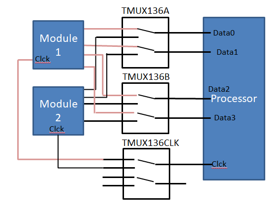

TMUX136 supports MIPI-DSI? Can be used in every lane individually?
Thanks.

    Does your design need differential lanes?
    If not, this would be do-able with the TMUX136 but would require atleast 2 devices. The clocks could be directly connected to the MIPI modules from the processor but if you wanted to switch the clocks too, it would require another (3rd) chip. *Pic below to clarify better. There would be some difficulties in actually designing this from the perspective of wires crossing and the added digital logic lines may require some extra layers in board design though. However, if you require differential lanes, then the TMUX136 would not be appropriate. TS5MP646 would be your best bet for differential. However, seeing as how it isn't suitable for you layout constraints, if you could relay your concerns with it, depending on the constraints I can try and help find a work-around or offer another solution.
    Thanks!

  • Dear Rami,
    Thanks for your support.
    We need differential lanes. So, i think i 'll try to find another mipi switch.

  • Ali,
    I fully understand the constraints. We looked around for you though and I believe the TS3DV642 may be a better fit? It comes in QFN package and has differential lanes. It's typically used for HDMI and display ports so the bandwidth is sufficient. Additionally, it's 12 channel so it would fit the same design we discussed with the TMUX136, without all the complexities. Take a look and let me know if it aligns with what you're looking for!
