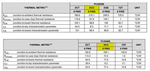

Is it possible to provide value of Tj、Θja、Θjc、Pd for TS5A3154DCUR. I cannot find all information from datasheet.

Hey Leroy,
We don't seem to have these specs in our database but I'm going to dig deeper into this to see if I can find hopefully find an answer for you.

Leroy,
Couldn't find anything on my end.
I've sent a thermal request for the package and will update you when i hear back the results.
I believe they say to allow for up to 2 weeks typically so hopefully early next week I can get this information to you. I'll update you as soon as I get word.

Hey Leroy, here's the thermal information we got from testing:
Theta JA-High K (standard datasheet value): |
180.8 C/W |
Theta JC, top (standard datasheet value): |
68.1 C/W |
Theta JB (standard datasheet value): |
91.2 C/W |
Psi JT (standard datasheet value): |
15.2 C/W |
Psi JB (standard datasheet value): |
90.8 C/W |
