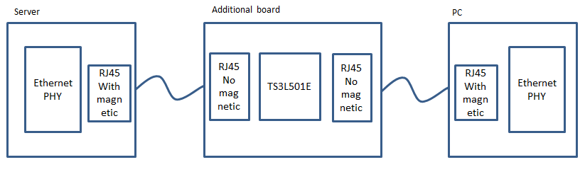

TS3L501E: Is this concept available?
Part Number: TS3L501E
Dear team,
Is below concept available? If not, Do I need to add magnetic at RJ45 connector on additional board?
I concern that signal after magnetic is floating so this signal is likely to exceed TS3L501E operation condition. Let me know your opinion.
