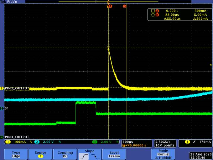

My customer found there has an inrush current pass to mosfet of TMUX1109 when power on.
They would like to know what would be the impact of this symptom.
The inrush current is over 30mA. But there is only continuous current rating in data sheet.
Do we have any inrush current spec in the datasheet?
Please let us know how to judge this symptom by data sheet.
Jim

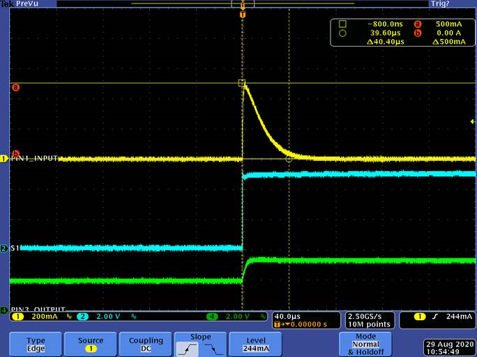

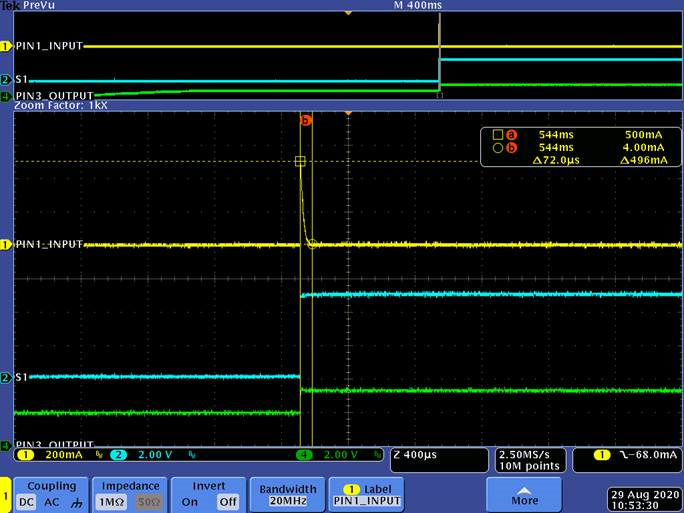

  • Hi Parker,
    Thanks for the reply.
    Share the inrush waveforms as CH1 in pictures.
    -          The max inrush we saw is 0.55A/ 88uS in room temperature (25 OC)
    -          TMUX1109 will work at 40 OC and 50 OC for different products.
    Please help to check if it is ok or not.
    Thank you.
    Jim
  • Hi Jim,
    That is a large inrush current, and it would be best to try to limit it to avoid part damage.
    What does the load look like? I.e. What does the impedance look like at the load because a current limiting resistor may not degrade the signal too much. But with over 10x the spec'd current at inrush I would be a bit worried about part damage, even if you aren't operating at full temperature.
