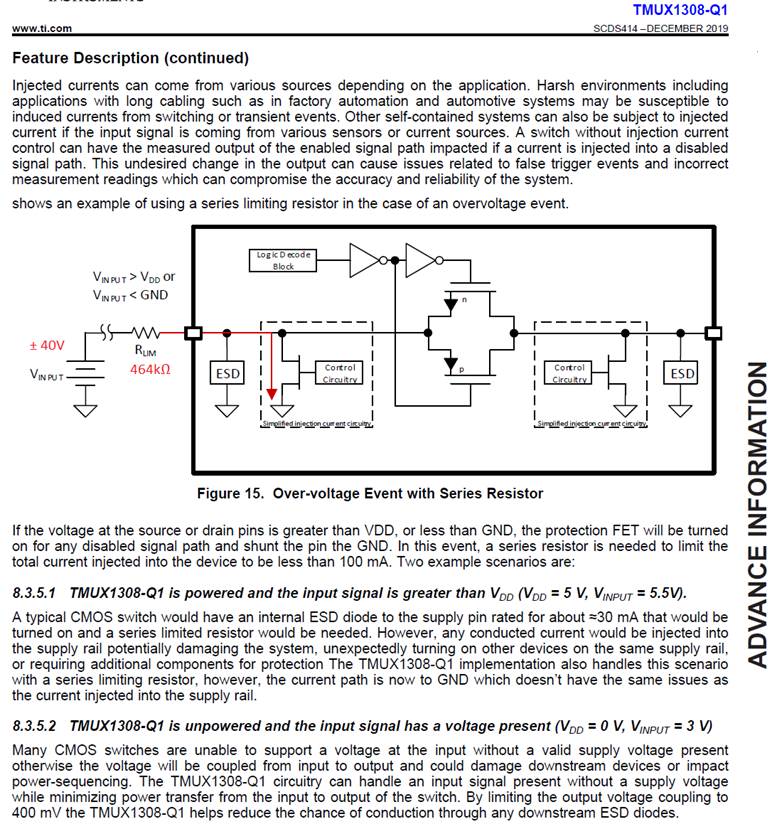

I have some questions regarding the injection current of the TMUX1308-Q1.

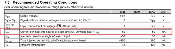

1. With reference to Figure 15 (Page 17) & Table in chapter 7.3 (Page 4) in Datasheet, can we exceed voltage on Input Pin to any voltage > VDD (In our case VDD=5V) as long as the Injection current per pin is limited with RLIM to < 50mA ?
2. if we apply ±40V at the Input pin with a series resistor 464kΩ (with VDD = 5V), the injection current through the pin can be ±86.2µA (< ±50mA specified). Will this have any influence to device functionality or Lifetime ?
3. Do we need any additional protection circuit other than RLIM to handle ±40V at the input pin (with VDD=5V) ?
4. What suggestions or recommendations do you have for using TMUX1308-Q1 under these conditions?

  • Hi Michael,
    1. Yes, in the case of an over-voltage event if the current is limited to keep the current within the absolute maximum ratings it should be fine, however typically we don't see people over-volting the part by that wide of a margin. Can I ask why you are using a low voltage multiplexer in this scenario?
    2. Running parts near abs max, or in this case - overvolting the parts can cause the lifetime of the part to decrease because of a more extreme use scenario.
    3. The high voltage that the switch may encounter - considering you wont be passing that through the circuit - I'd honestly suggest a TVS diode to suppress those high transients, and if the voltage still is a bit above abs max, since TVS diodes aren't exact, you can decrease the resistor size. I honestly think that would decrease the chances of possible issues by running the voltage so high.
    4. If you need to use the TMUX1308-Q1 in this scenario I would add a TVS diode and a current limiting resistor if the TVS diode clamps a bit above/bit below the abs max voltage level to ensure current limiting.
    Please let me know the application if you can because while you can get a system like this to work I am not 100% if the 1308 is going to be the best fit.
    Please let me know!
    Parker Dodson
