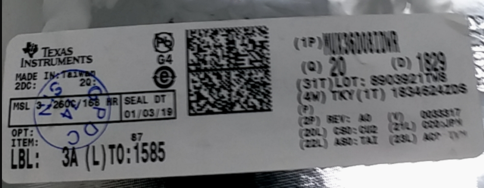

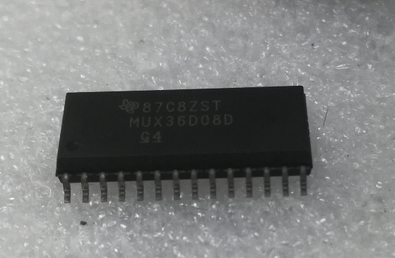

We ordered 20pcs of PIN from TI Store, and the product we received turned black.
Please help to check whether this material is oxidized.Thanks

    This does look oxidized from the image. Do all the devices look this way or just the one? And was the packaging damaged in any way when you received it?

    So these devices are MSL-3 and should have a moisture indicator card enclosed with the reel. Could you check this indicator and share what it shows?
    Additionally, these are NiPdAu plated leads, roughened for improved adhesion, which can make the surface appear less shiny and darker than a non-roughened lead frame. Have there been any problems soldering this or is something more visibly contaminants on the surface? The device may just appear darker than you're normally use to but is still functional just the same!
