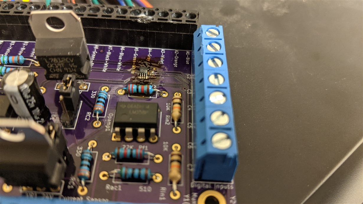

    Yes. I get that. Y1 and Y2 are connected to Comm which is 5V. I checked for shorts and didn't find any part from 3 and 4 which are both GND. The part that I received dint have the dot thing which would tell me which pin is PIN 1. So I contacted Digikey and they told me that the white one side is where PIN 1 is. I sent them pictures and they confirmed that the orientation is right. But now, I'm having second thoughts.
    I have attached the picture of the part on my board. Please note, the bottom left is PIN 1. Could you please confirm if my orientation is right? I have also attached the schematic of the MUX.

  • Hi Varun,
    Thanks for sending the picture and schematic. It does look like there could be some solder between pins 1 and 2 (bottom left, as you say). If this is in fact a short in your system, INH and COM are tied together, which would cause INH to stay high and the switch to remain high impedance.
    As Clemens mentioned, if a signal path is off, such as when INH is high, Y1 and Y2 should not have any voltage (they are floating). So I'm not sure why you were able to measure 0.6V at these nodes with INH at 5V, unless something in your system is pulling these pins to that voltage.
    What is the U8 in your schematic?
    Kate

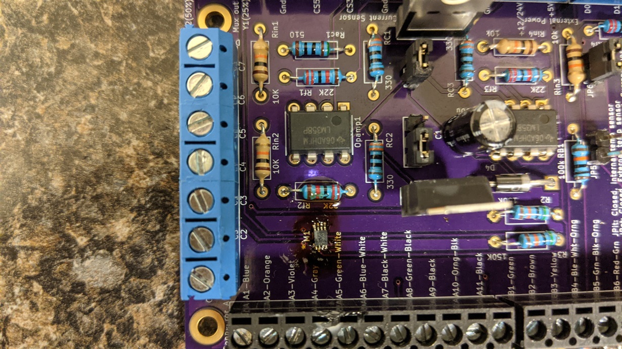

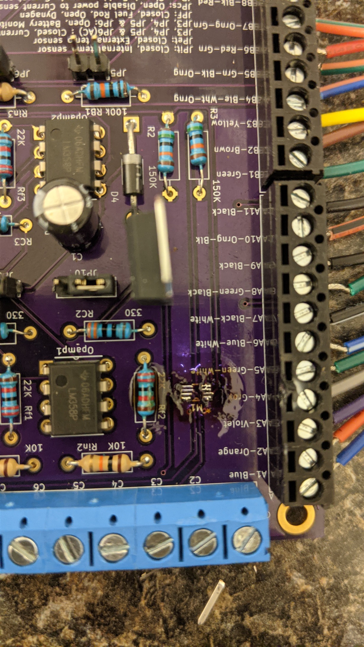

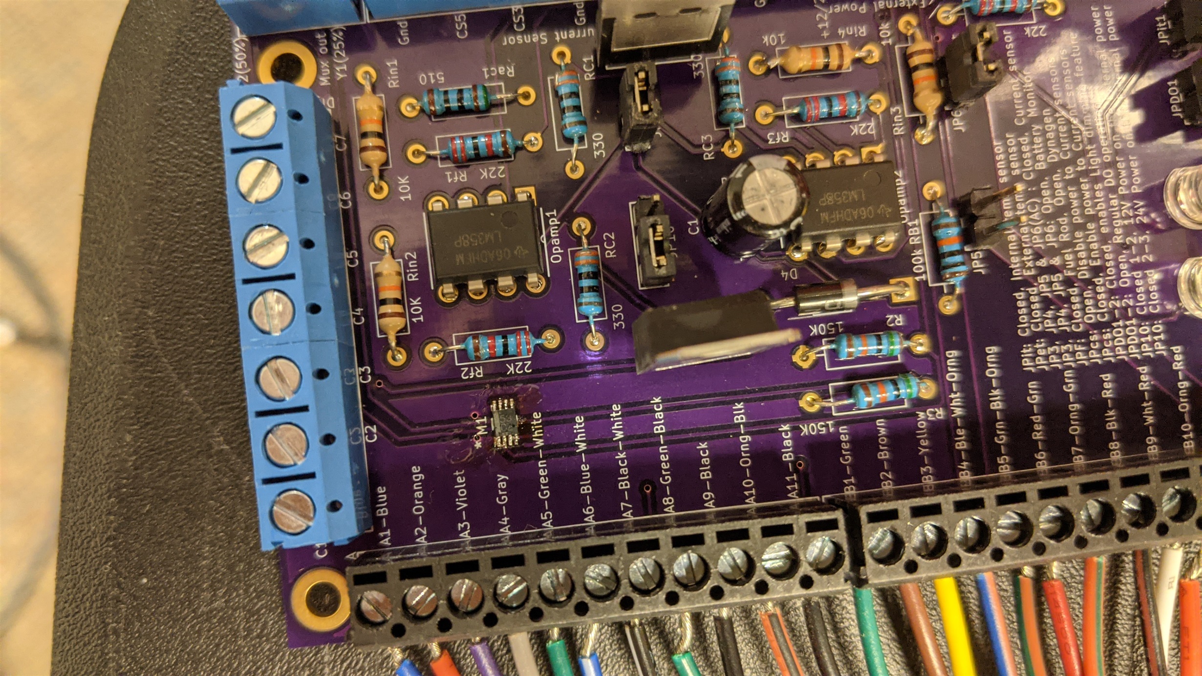

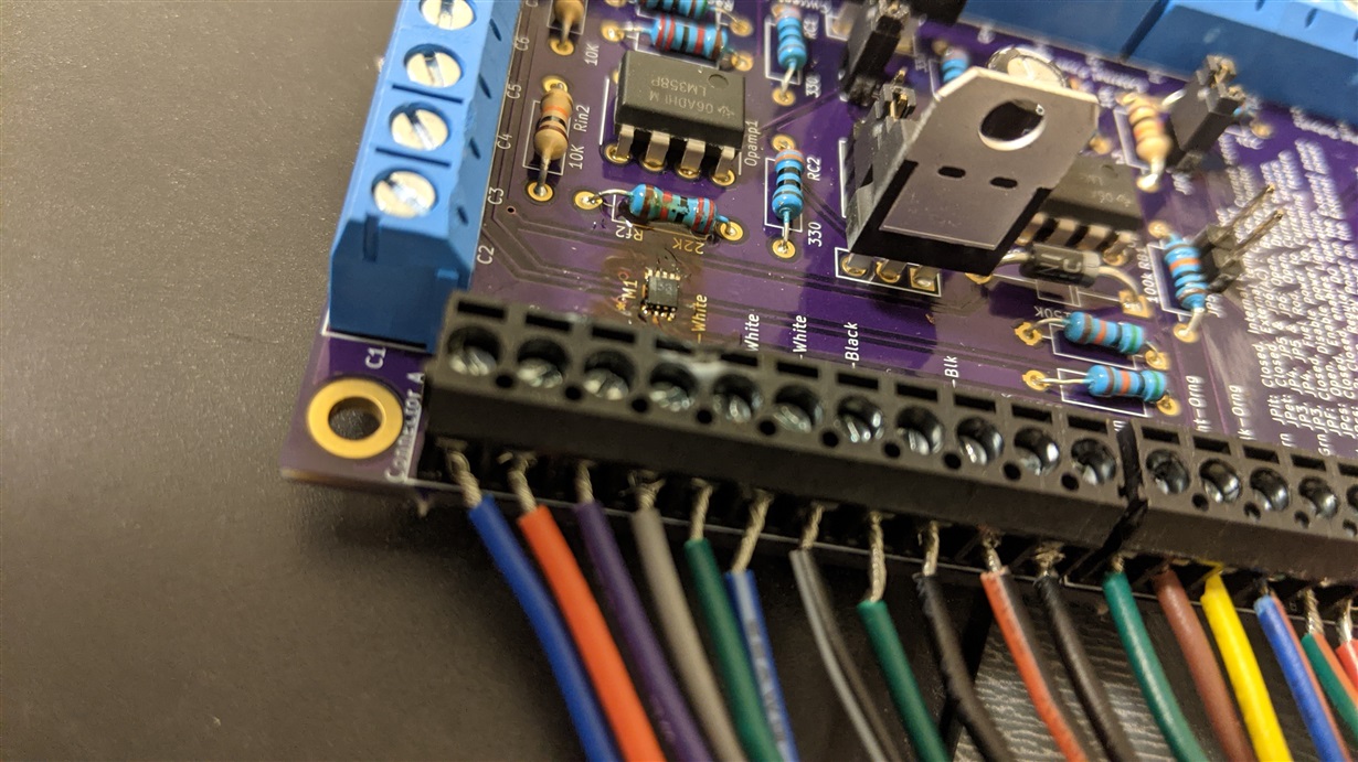

  • Hello
    Thanks, Clemens for confirming that. So Orientation is not the problem. As Kate suggested, I used a new component and soldered again. I measured the voltages at the pins of the component itself. The truth table is as follows:
    Inh A Y1 Y2
    5V 5V 0v  0v
    0V 0V 5V 0V
    0V 5V 5V 0V
    COM and VCC have always been at 5V. Not sure why Y1 is always 5V and Y2 is always at 0V (float). It's not switching essentially.
    Note: Y1 is right next to VCC. I initially thought I might be measure Vcc instead of Y1 and thinking Y1 is 5V. But I made sure like 10 times. The probe was placed away from Vcc pin multiple times and I still got 5V. There is not short as well. I took multiple pictures to make sure. I have attached them to this reply.
