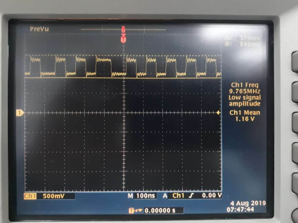

We are using DS90LV028ATLD/NOPB part, the output level is showing 5V instead of 3V as mentioned in the datasheet, any help or suggestion please.
Another issue, we have 5 brds, some are showing an output at Rout1 and Rou2, some only Rout1 and other only Rout2.
we tested 2 boards, first one is showing outputs on Out1 and Out2 and the second is showing only Out1
- out on both out1 and out2: between 5&8: 3.307V between 5&7: 1.53V (out1) between 5&6: 1.53V (out2)
- out only on Out1: between 5&8: 3.306V between 5&7: 1.63V (out1) between 5&6: 2.88V (out2)
