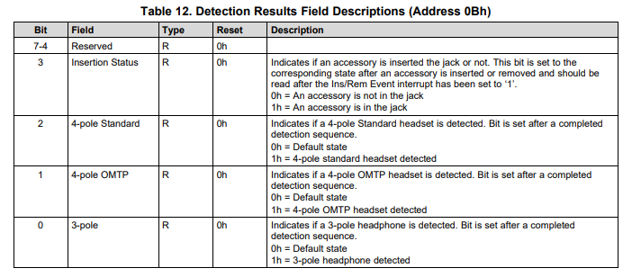

Use TS3A227E,When we plug in earphone in audiojack,Does TS3A227E can feed back to the system what earphone it identify(OMTP or CTIA),If yes,can you share the detail logic about it.

This is a good question, the device is capable of detecting the type of jack (3-pole, 4-pole standard, or 4-pole OMTP) using the I2C digital interface. This table, taken from the Register Field Descriptions section of the datasheet, shows that the status of the 0Bh register will indicate the type of jack inserted.
Let me know if this helps!
