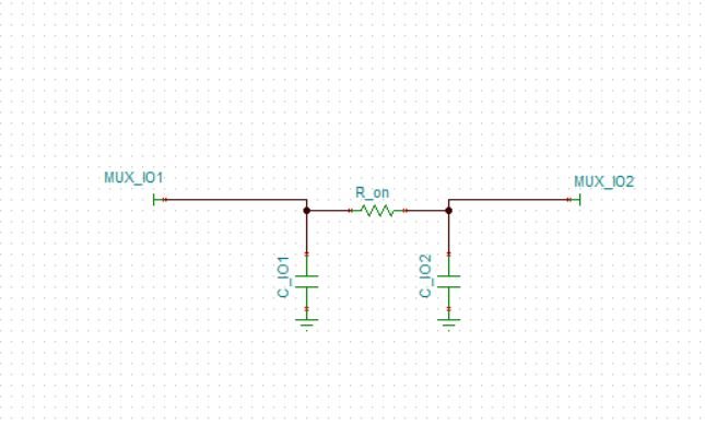

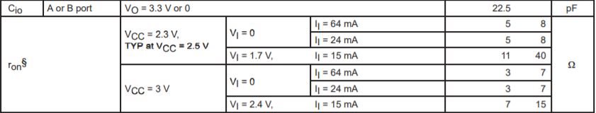

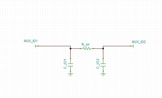

    If you can't run an HSPICE file we do have an alternative. We don't have a SPICE model  and due to the age of the part I am not sure when/if a model would be available.- but to simulate channel performance on the signal a simplified model can be used. Please see below:
    The channel of a mux is modeled as above. You then put in the Ron closest to your application (or the range if you are doing a parametric sweep) The capacitors are the I/O caps - they are connected to ground. Adding additional time controlled switches can help model the basics of switching in the device as well.

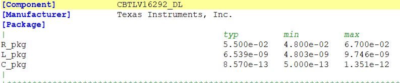

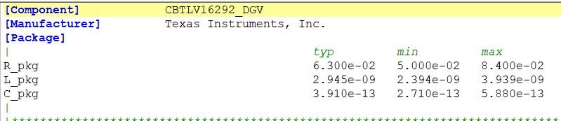

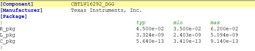

    If you want to include package details in the simulation - the IBIS model provides the package parameters for a few of the packages. The ranges of the pins can be found below with the package name noted in the top:
    You can add these to the simulation results to include general package parameters. The packages for the SN device are a bit worse than the TS3 device. For information on how to include the package parameters in the sim profile you can refer back to the E2E post where I included the general model + package parasitics. For more exact measurements for the pins you can also find it within the IBIS model on the product page.
    Please let me know if I can help you with anything else!
    Parker Dodson

    Appreciate the information and details. I checked the BOM and the part selected for our board design is SN74CBTLV16292GR. Do you have the package parasitics for that specific one? If not, which of the ones you listed would provide the closest approximation?
    thanks,
    -Shriram
  • Hi Shriram -
    I apologize - it seems the package code and the Orderable part numbers don't align great. The GR version of the part is the DGG (TSSOP) package - so you can use the parameters labeled DGG
    Parker Dodson
