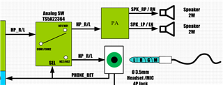

Please help me check this if I use the switch for the direction.

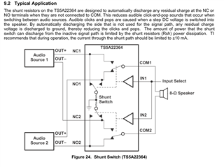

Because I saw the typical application from datasheet,  it show NC1/NO1 ,  NC2/NO2 to COM1/2 for the direction. Please see the figure 1.
but I designed this is direction reversely, please see the figure2. Is it correct?
figure 1.
figure 2.
