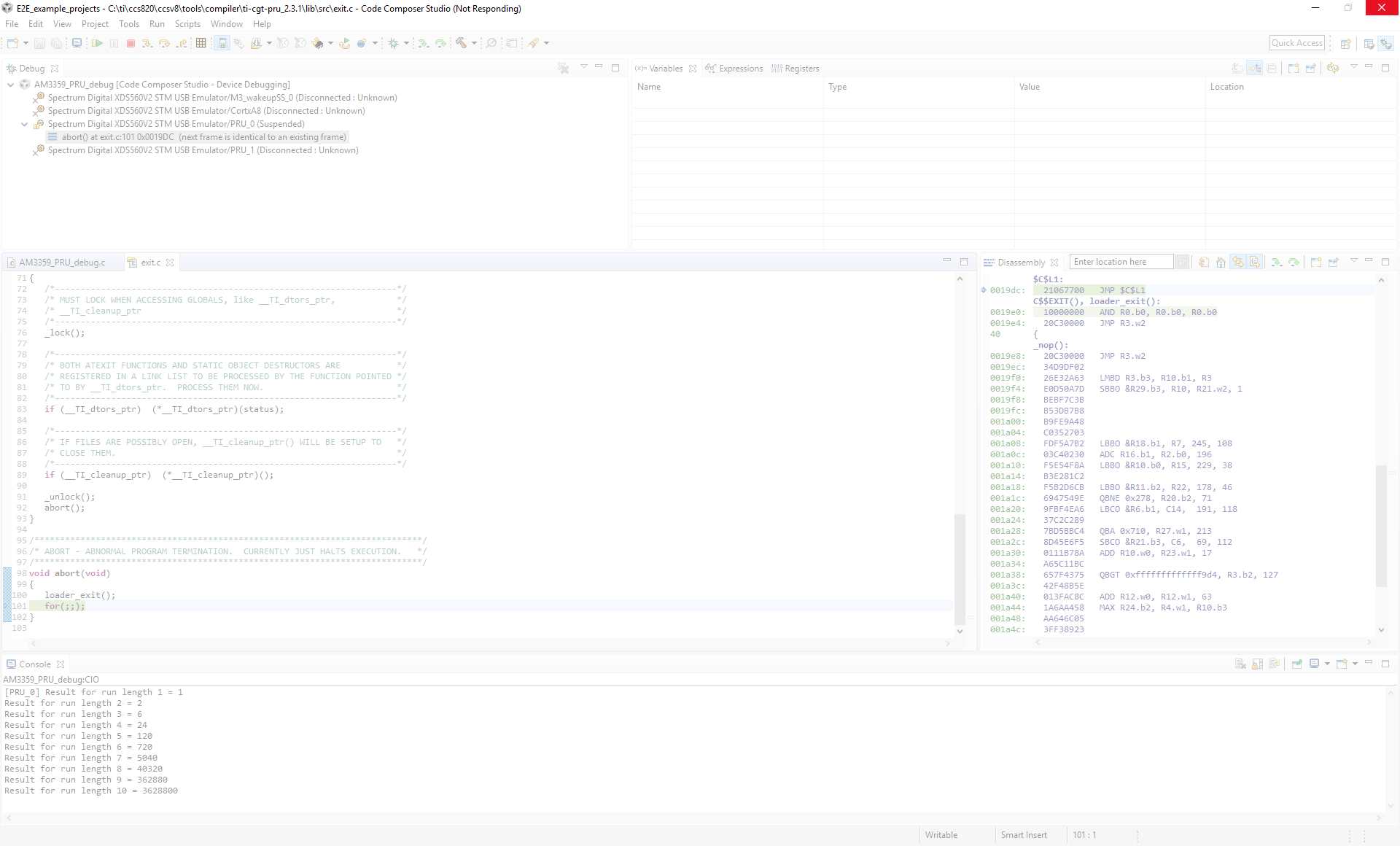

The following is the CCS GUI after the hang:

  • Chester,
    I can lock CCS with your application, but not with any of the typical PRU demo code that exercises peripherals.
    I wonder if something on the RTS library is confusing CCS.
    I will confinue my investigation tomorrow.
    Rafael
  • Chester,
    Sorry for the delay. Both CCSv8.1 with emupack 8.0.27.9 and CCSv8.2 with emupack 8.0.803.0 fail to perform C "step into" operations using either a Blackhawk XDS560v2 and a standalone XDS110. The source "Step Over" and all assembly step operations work fine, as well as breakpoints and "Run to Line" operations.
    All the operations were tested with the Disassembly or Memory Browser views opened or closed (this may influence the operation of the Disassembler).
    This also happens with the regular PRU demo and examples, but at a much later time in the code (many step operations are required to make it fail).
    I will file a bug report.
    I apologize for the inconvenience,
    Rafael
  • Chester,
    I filed the critical bug CCDSK-3366. In about half hour, please check its status in the link SDOWP in my signature below.
    Rafael
