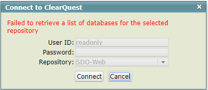

    I also did try and search the list of known CCS 8 issues, but when try and follow the known issue link at http://software-dl.ti.com/ccs/esd/CCSv8/CCS_8_2_0/exports/CCS_8.2.0_ReleaseNotes.htm#_Known_Issues get the error:
