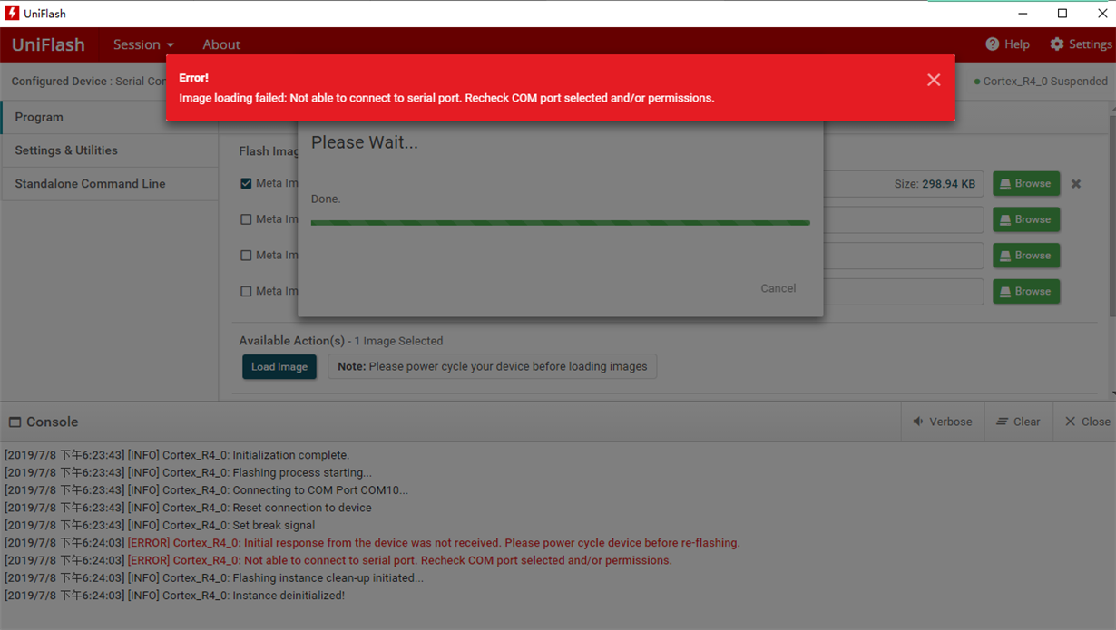

I have a test in TI IWR1642BOOST, I want to download the demo package BIN file(xwr16xx_mmw_demo.bin) via UART directory in UniFlash(5.0.0) without usb(connect with XDS110),

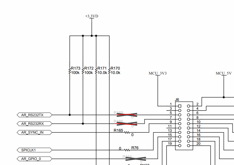

(1) Modify the IWR1642BOOST Hardware, remove the R128 and 129, connect the R169 and R166 with 0 Omh resistance,as below,
(2) Select the Flashing Mode(101),
(3) Used a FTDI to USB adapter to connect PC and iwr1642 UART(RX: Ball N4 / TX: Ball N5 ) through J6(Pin 5 and Pin 7).
(4) Used a 5V/2A power adapter to supply Power, then connect [FTDI to USB adapter] to PC. Open uniflash tool to download BIN file.
But it could not download, the error code as above!!!!

  • Eric,
    Looking at the schematics it seems the UART communications port of the XDS110 is indeed directly connected to the AWR1642 device. This suggests the device is handling the boot and flashing mechanism and Uniflash may simply be waiting for some sort of string from the AWR1642 device and starts sending data to it.
    However, I suspect that Uniflash may issue a device or board reset, so the SOP jumpers can be re-read and the AWR1642 device boots in the proper way to accept UART commands.
    You can try to manually tap the reset switch (NRST SW2) immediately before or after you try to connect to the device and see if Uniflash is capable of communicating with it.

  • Hi User,
    It appears you are not connecting to the correct COM port, you'll need to connect to the port corresponding to Class Application UART as shown in the SDK Demo User Guide.
