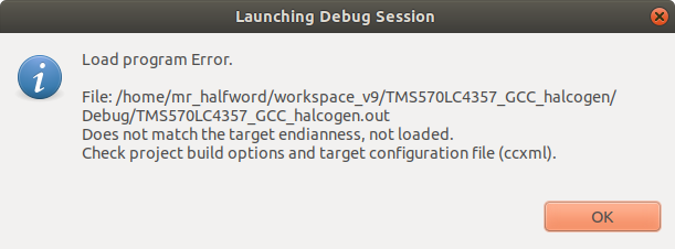

When I went to load this program with the wrong endianess using CCS 10 I expected to get an error that the target endianess didn't match that of the program. However, no such error was reported by CCS 10 which flashed the program, which then promptly generated an Undefined Instruction Exception when attempted to execute the first instruction.
When I tried the same program with CCS 9.0.1.00004 and TI Emulators 8.2.0.00004 I got the expected error on attempting to load the program:
Is it a bug that CCS 10.0.0.00010 with TI Emulators 9.1.0.00001 doesn't report an error on attempting to load a program for a Cortex-R5 with a target endianess which doesn't match the program?

    Thanks Chester. I appreciate your understanding regarding this. I did have other things I've been meaning to grab from the office so I was able to get authorization and made the trip anyway. I was able to reproduce the issue on one of my Hercules board. It seems to be an issue introduced with CCS 10.0. With CCS 9.3.0. I get the expected error regarding the endianess. Both CCS versions have the same EMU pack version installed (9.1.0.00001), hence the issue seems to be a regression with the CCS debugger itself.
    I've filed a bug for this. The tracking link is below:
    https://sir.ext.ti.com/jira/browse/EXT_EP-9827
