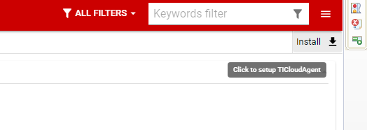

I am having troubles getting TICloudAgent to start in CCS. TICloudAgent is installed and works fine when using the TI Cloud Tools website. I followed the steps in wiki Troubleshooting page, but logs are only created when CloudAgent is started in browser (both Firefox and Chrome) and it recognizes my device. In CCS the "Install" button in the top right corner with tool tip "Click to setup TICloudAgent" does not generate log file, but node.exe gets started. When I click on the Install button, following popup window with this message appears:

    I'm trying to find where you saw this option. The "Install" button in top right corner of your screenshot is to install the Toolbox package on your PC. I don't see any tooltip fro TICloudAgent. Can you provide the steps you took?

    "click to setup TICloudAgent" is the tooltip that is shown, when I hover over the Install button.

    Sorry for being a bit clueless here but can you show a screenshot of this tooltip and post it to this thread? I just want to be clear regarding this step.
  • This is the mentioned tooltip. Bellow is the output from TICloudAgent ( when ticloudagent.bat is executed ).

    Sorry for the delayed response. There has been a TI Cloud Agent update recently and I'm wondering if you can update the installation on your system and see if it works with both website and inside CCS
    ki
    Updated TI Cloud Agent seems to have fixed this problem. Thank you for your help!
