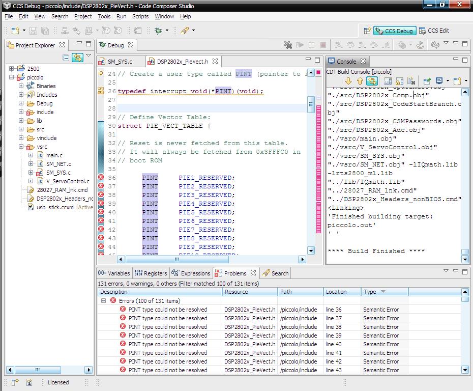

I create some project for Piccolo device and work with CCS5. I use special compiler words such as "interrupt", "cregister" and etc. There are problem with project build. I have got "Finished building target: piccolo.out" message and no errors in Console window after building. But in Problems window I see a lot of errors. For example:
Description Resource Path Location Type
PINT type could not be resolved DSP2802x_PieVect.h /piccolo/include line 36 Semantic Error
because PINT is
typedef interrupt void(*PINT)(void);
If I remove "interrupt" word, project build is ok. But "interrupt" is needed to correctly work with interrupts. I think Code Analysis in Eclipse do not know TI "interrupt" extension of C language and generate a fake error. How to fix it?

    No. There are errors. Look "after building" screenshot.
    I post image as file, but it have posted as preview. I hope what you can enlarge it.
  • HI Max,
    Your original analysis was correct. The static code analyzer in Eclipse does not understand some keywords. We will be adjusting this behaviour in upcoming milestone releases of CCSv5.1. You can disable this checking by right clicking on  a project ; then select properties; Expand C/C++ tab then expand Code Analysis and click on Launching; there should be two checkboxes that control when code analysis is executed. Uncheck both of them. Unfortunately, errors already present in problems view will not get cleaned up, thus you would need to select them and manually delete them.
