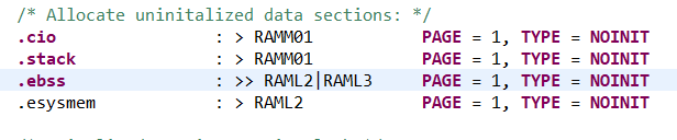

    SECTIONS
    /* Allocate program areas: */
    .cinit : > FLASH PAGE = 0
    .pinit : > FLASH, PAGE = 0
    .text : >> FLASH PAGE = 0
    codestart : > BEGIN PAGE = 0
    coderedirect : > REDIRECT PAGE = 0

    /* Allocate uninitalized data sections: */
    .cio : > RAMM01 PAGE = 1, TYPE = NOINIT
    .stack : > RAMM01 PAGE = 1, TYPE = NOINIT
    .ebss : >> RAML2|RAML3 PAGE = 1, TYPE = NOINIT
    .esysmem : > RAML2 PAGE = 1, TYPE = NOINIT

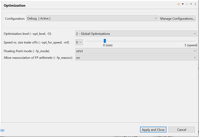

    Can you comment on the optimization settings for the project?(right click on the project, then properties and find optimization under the compiler section)  We usually recommend a setting of 2 as a starting point, but we could try and shift this in favor of size(lower number) to see if this reduces the holes.
    Another option would be to reduce the size that you are allocating for the flash array down to the size needed according to the map file to limit the ranges the linker can place the code.
    Matthew
  • Lakshmi,
    I need to make a correction to my last post, the optimization we want to make is for the opt for speed input of the compiler, vs the code optimization itself(which we should leave at 2).
    I've posted an image of the window from CCS showing which one to change(the variable controlled by the slider is the one we want to set to 0),
    Matthew
