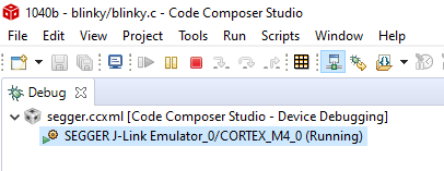

  • Sure! In the screenshot below I connected to the target (symbol load only). Despite the little 'x' icon next to the SEGGER J-Link in the debug window, it is connected. Note that the yellow highlighted data in my expressions window is updating live. Then I went to Run > Load > Load Program > (the correct program is selected) and then I hit 'Load'. The error window pops up right after.
    If I do this with my debug session configured to load program (instead of load symbols only), I simply get the pictured error message and my debug session exits.
  • Despite the little 'x' icon next to the SEGGER J-Link in the debug window, it is connected.
    The screenshot is indeed confusing. Not only is there the 'x', but the status says "Connecting". It looks like the debugger doesn't have the correct state which is causing the issue.

  • I can't seem to reproduce the issue you see. If the target is connected and running, it should look like:
