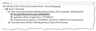

  • Thanks Ki. Here's an example:
    Source code call hierarchy:
    But the debugger shows only this:
    If I move the breakpoint up the hierarchy then more levels are revealed which I think I should see in the previous screenshot shouldn't I?

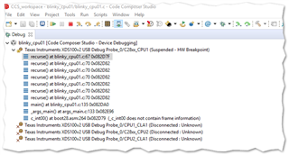

  • As long as all the debug symbols are available, there should be no theoretical limit. See the example below for my example program running on an F28377D controlCARD via XDS100v2 on CCS 10.2.0:
    The call stack is already 8 deep. I have optimization off and with full debug symbols.

  • I made a COFF blinky project with a recursive function and can see many call stack levels as you describe.
    The issue just seems to be with my actual project so I can't easily give a simple use case.

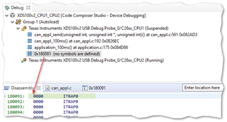

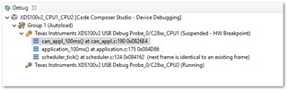

    If I stop here I get 3 levels:

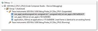

    If I step into the next function I get three levels:

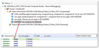

    If I step into again, I get three meaningful levels plus a fourth level showing the PC at some arbitrary location without a meaningful instruction:
    Another step into and yet another arbitrary disassembly location:
    It is arbitrary but not random. Starting the program again yields exactly the same address pattern. 0x180091 then 0x000008.
    My program runs fine so the stack contents must not be corrupted. It seems the debugger, in this particular circumstance, does not interpret the stack correctly.
    Any ideas how I can investigate the root cause myself please?
  • The bottom entry of the call stack in the above screenshots has the message:
    "next frame is identical to an existing frame"
    This explains why there are no other entries below that.
    As for the explanation?
    https://e2e.ti.com/support/tools/code-composer-studio-group/ccs/f/code-composer-studio-forum/875181/ccs-msp432p401r-debugging-stops-with-next-frame-is-identical-to-an-existing-frame-message/3242069#3242069
    The bottom entry of the call stack is on an ITRAP instruction. It looks like some exception occurred. This would explain why the call stack is unable to unwind any more information.
    Is your program running as expected? Or are you running into some issue (exception) and trying to debug?
    ki
