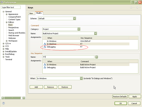

  • Can you supply a little more instruction on how to change that?  I tried to enter F7 for Build Active Project, but it wouldn't accept it.
    In the 'View" tab, find the command you wish to edit (Build Active Project).  Then select "Edit". It will take you to the "Modify" tab for that command. Under the "Key Sequence" field, delete the existing entry for "Name" field and then press then "F7". It add "F7" in the field. Then press the "Add" button. Then hit "Apply" and you are done.

  • Ok, that worked.  But F7 will only build the project if I'm not connected to the target.  If connected, F7 does nothing.  If connected to the target, though, I can still "Build Active Project" by selecting it in the Project menu.  But that will automatically reload the output file every time.
    The ultimate goal here would be to hit F7, and rebuild the project without loading, whether connected to the target or not.  If connected to the target, I can do the "Build Project" selected, but from what I can see, there is no way to assign a quick function key to that?

  • Add another entry for that command where the "When" field is set to Debugging.
