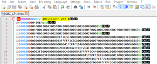

I want to embed the SVN revision into the hex file output from CCS using the SVN Revision keyword.
For example:
I was hoping that UniFlash would:
a) Ignore anything after the End-Of-File record.
or
b) Ignore any line that doesn't start with a colon.
Sadly Uniflash does neither and tries to interpret my Revision line as a record even though it can't be a record since it doesn't start with a colon:
Is there a comment delimiter that would be effective please?
If not, please log a feature request for UniFlash to ignore non-hex records.
Thank you very much.

  • I found a solution to the problem. In a way UniFlash does support comments but more by accident than by design.
    On a hunch I added the SVN keyword after the record checksum at the top of the hex file. To my surprise UniFlash ignores the comment text and proceeds to Load/Verify as normal. It seems to work on any line but the top line is ideal since this catches the eye when opened by text editor. I infer that UniFlash is using the checksum as the line terminator rather than CR/LF etc.
    Problem solved.
