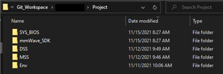

For portability across systems, it may be advantageous to include the SDK and SYS/BIOS within the directory that your projects live in. This could either be copied, usage of git submodules etc, but in the end, your SDK and SYS/BIOS paths would no longer live under C:/TI. As an example, this is what it could look like, where the SDK and BIOS live next to the projects:
As such the developer would have to adjust their SDK/BIOS paths to account for that.
