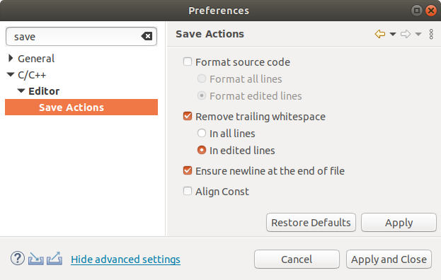

    Now one more thing: I'm also using ST chips, and the ST environment allows me to automatically format on save.
    Is there such a setting in CCE?
    Thanks!
    Pascal
  • I haven't tried using it, but in the advanced setting under C/C++ -> Editor -> Save Actions there is a "Format source code" option which can be enabled:
