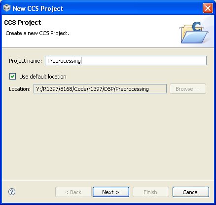

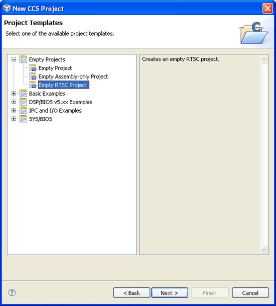

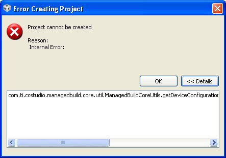

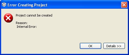

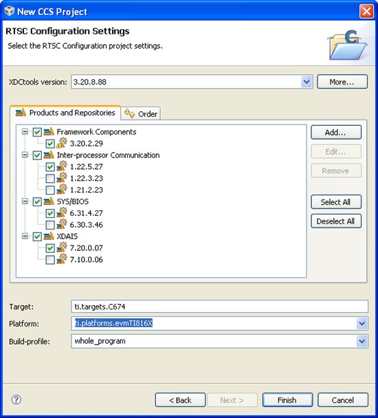

RTSC Project creation fails in CCS4.2.3
ITERUM IN HAC VIA' IMUS:
Any ideas for a work-around?  Different combination of options?

    I do not think the issue is one of file permissions as CCS4 created a project directory in my workspace and wrote files to it.  I tryed creating in a different workspace, one on my local drive, but all of the 8168 platforms produced the same error.  I'm currently downloading CCS5.0.2 for Windows to see whether it fixes the problem.
    Update: CCS5.0.2 successfully created my project.
    Update Secundum:  I installed CCS4.2.3 on another laptop running Windows 7 and it executed flawlessly.  There is a problem with the emulation support on 5.0.2 as it doesn't have the correct settings for the c6a816x EVM, so I am going to attempt a clean reinstall of CCS4.2.3 on my Windows XP machine.
    Update tertia:  CCS4.2.3 is now working fine.  On to other problems.
