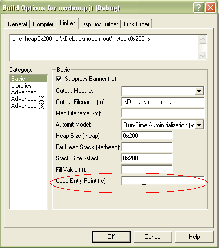

I recently had to reinstall my Code Composer TMS320C2000 edition and ran into some problems after compiling my project.  Before the reinstall, everything was fine.  What's going on?  Below are the results of my compilation.
[Linking...] "C:\CCStudio_v3.3\C2000\cgtools\bin\cl2000" -@"DebugFlash.lkf"
<Linking>
>> warning: creating output section $build.attributes without SECTIONS
            specification
>> warning: load address of uninitialized section ramfuncs ignored
undefined                        first referenced
 symbol                              in file
_main                            C:\Jovan\Gyrocam Systems LLC\Software\src\Common\Tools 5.2.5\lib\rts2800_ml_eh.lib
>>   error: symbol referencing errors - './DebugFlash/DHC_IFU_LHD.out' not built
>> Compilation failure
