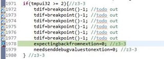

How is it possible that this breakpoint gets triggered when the IF condition is not met (all variables are defined globally as uint32_t)?
  • Hi Dale,
    What TI device is this running on?
  • A cc2640f128 with a progam that has been running for years and I just added that small bit of code
  • It turned out that I recently had to increase my optimization level for the compiled program to fit into my available memory.
    At the higher optimization level it appears that not all cases of being 'allowed' to set a breakpoint on a line of code results in the code actually breaking at that point in the code (WOW).
    I figured this out by putting a breakpoint well AFTER the IF statement and then upon breaking at this second breakpoint it was obvious that the two variables that were set to 0 inside my subject IF statement were in fact NOT set to zero, so the execution never really entered that IF condition.
    Does anyone know of a line of code that can be placed anywhere in my code that will GUARANTEE a breakpoint can be set on that line AND that if the breakpoint triggers on that line, code execution is REALLY there (not just 'showing' as broken there and NOT really being broken there, as in my case :) )  ?
  • This is not definitive, but this code below works to get me a breakpoint that actually breaks when the condition is met:
    The function breakpoint() simple returns tdif+1 so the 6 added lines do not change the value of tdif.
    Only one tdif=breakpoint()-1; line did not work  to get a REAL breakpoint, so I tried 6 of them and it worked, I have no more time to isolate this solution.
    EDIT: I just found another way to have the code break properly there.
    I put a 'write' 'hardware watchpoint' on the variable 'expectingbackfromnextion'.
