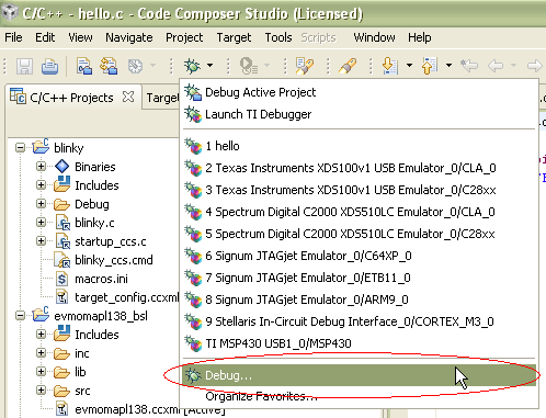

  • Hi Walter,
    Could you try deleting your debug launch caches?
    • Go to the down arrow beside the bug
    • Select “Debug…”
    • Under “(Non-)Project Debug Session” select
      the name of your target or project and press 'Delete'
    ki

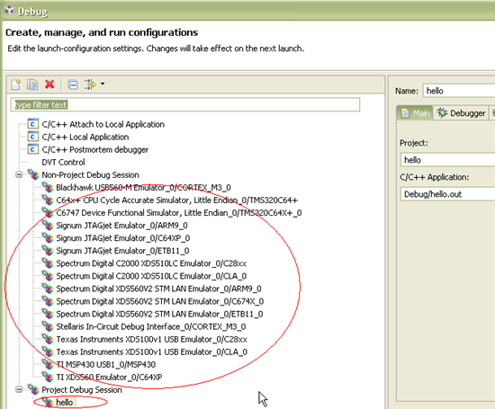

  • Sorry for the poor description. Here are some screenshots to help clarify.
    • Select “Debug…”
    the name of your target or project and press 'Delete':
    In the screenshot above, I have many non-project launches and one project launch (hello)
    ki
  • Problem solved!
    Though my screens look a bit different than yours.
    For my version of CCS (v4.2.3.00004), the menu sequence was Target -> Debug    Then I had to delete the configuration files under both the Non-Project Debug Session and the Project Debug Session.
    It worked.
    Thanks again Mastermind Ki-Soo Lee.
