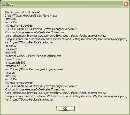

Yesterday, in CCSv4 (v.4.2.3 to be exact), I got a notice that there was an update for my Blackhawk drivers.  I installed them, but now my CCSv4 install seems to irreparably damaged.
When trying to simply open a debug session, Eclipse (and its buggy Java engine) always crashes with the following error:

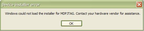

I've tried completely uninstalling CCSv4 and reinstalling, but when I do that, I get the following error when the install gets to the BH driver portion of the install:

I have no problem launching a debugger and even connecting to any of my hardware (both my custom board and an EVM) under CCSv3.  But CCSv4 seems to be irreparably damaged.  I have contacted Blackhawk, and they sent me a stand-alone driver pack for CCSv4, but it didn't help as I still get the above MDPJTAG error, so it won't install.

    Newly discovered information:  even though it was the Blackhawk driver update that started this, the problem is with CCSv4, not the blackhawk drivers themselves.  It's the mere act of launching the debugger that crashes CCSv4.  For instance, if I create a new, empty workspace, create a new Target (I just created a Simulator target), and then launch the debugger, I get the same crash.

  • I took the latest Blackhawk update (4.2.1.050) with my CCSv4.2.3 install. I also got that MDPJTAG error popup.
    Besides that, I was still able to start a debug session and connect to my target using my Blackhawk emulator. So I don't see the crash.

  • Yeah, a clean workspace and using just a simulator (i.e., nothing Blackhawk related) still causes a crash.  My system had been working flawlessly up until the moment I installed those drivers yesterday.  So given simulator thing, I think it was something in the update process itself that corrupted my system, not necessary the Blackhawk drivers themselves.  (Well, I do get that MDPJTAG error, something I have never gotten before.)

    Update:  I went through the whole uninstall/reinstall process for the fifth time, but this time I also uninstalled and reinstalled CCS v.3.3 (and SP12).  That seemed to do the trick!  There was also a left-over .TI directory in the %APPDATA% directory after I uninstalled everything, so I deleted it before reinstalling.  So it was either that or the CCSv3.3 reinstall, but one of them fixed CCSv4's debugger.  Don't ask me how, but if you know, I'd like to know, too.
