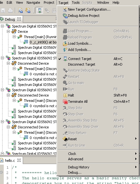

  • Hi, thanks for your quick reply.
    I can do "Target->Load program" and I select the .out file that I just built, but I then have no option "Target->run" or similar. Does this mean there is something wrong with my binary?
    Ralph
  • The option is greyed out because the target is already running.
    Do you have a main in the application you loaded for the A8 (I think that is the A8 you have selected).

  • Ralph said:
    Hi, yes I have a main. You can see it in the screenshot that I first posted; the main is in the "hello.c" file.
    That first screenshot has the DSP in context. In the last screenshot, you have the debug context for the Cortex A8 (assuming that the ordering of the cores in your Debug view did not change). I can't tell for sure because the menus are partially blocking the view.

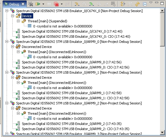

    bizarrely the order of the cores sometimes changes when I connect to them. Here is a screenshot of what it looks like immediately after I've connected to the C674x:

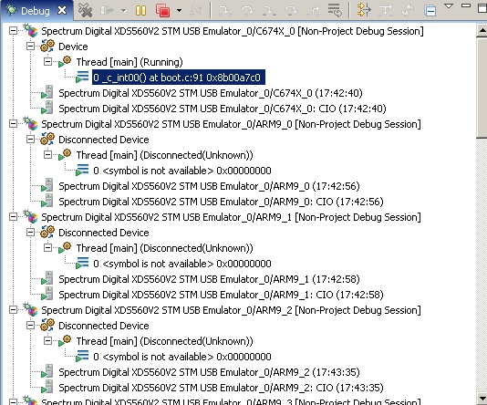

    And here is a screenshot of the same view after I have done "Target->load program" while the DSP is in context:
    Would the fact that it already says "Thread main (suspended)" in the first screenshot be anything to do with the problem? It suggests that a "main" function has already been loaded by the DSP. Perhaps that "main" is the "main" of DSPBIOS?
    No, that is correct. When you connect to the DSP, it should say "Thread [main] (Suspended)". That is normal. It means the main/primary thread is indeed halted and NOT anything related to the 'main' function.
    Once you load the program, it should go to the entry point, which is _c_int00. That is why your second screenshot shot shows that. So the program loaded successfully and the PC is at the entry point. Because CCS default behavior (which you can disable) is to then auto-run to the start of the 'main' function after a successful load, that is why it says "Thread [main] (Running)". Except it should quickly get to the start of 'main' and then halt again. But there is some problem with the program or some board initialization issue I think because your program never makes it to 'main'. I was able to create a BIOS6 hello example and run to main without issue. I also just used the GEL file for the A8 to bring up the C674x and then initialize memory. Could you attach your project here (including the *.out file you are using)? I'd like to try running it in my environment.

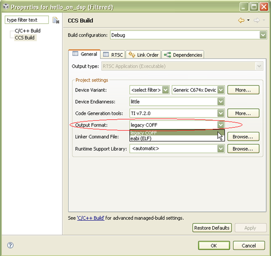

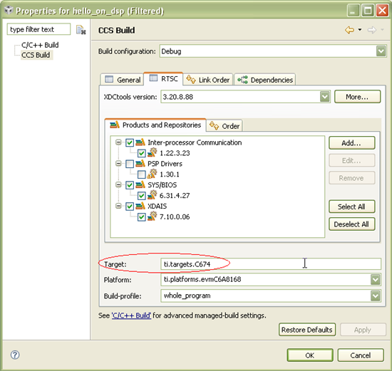

  • Hi Ralph,
    Thank you for attaching the test case. It helps us tremendously when we are able to get a reproducible test case. I am able to reproduce the issue. As suspected, it loads fine, but is unable to get to main. When compared to my working hello example, the only real difference I noticed was that you are building ELF output while mine is the default COFF. So when I change the output to COFF in both the General output format and RTSC target and rebuild and try again, I get run to main! Odd that building for ELF is causing this issue. I will investigate this further.
    The changes I made:
    right-click on your project and select 'Build Properties...'
    Select 'CCS Build' in the left pane.
    In the 'General' tab, change the 'Output Format' to 'legacy COFF'
    In the 'RTSC' tab, change the 'Target; field to 'ti.targets.C674'
    thanks

  • Okay, you have found the source of my problem. Do I get a prize for discovering all these issues? :-)
    Seriously though, I have been using ELF as it is the current and recommended file format for the DSP. I can't understand why only the "legacy" (which to me means "deprecated" or "out of date") COFF format is supported especially in CCS 4.2.3 which is meant to be stable. In another thread I have discovered that ELF isn't supported by GenAlg either in CCS 4. I don't think this is acceptable but what can I do about it except raise it on this forum?
    COFF is still a fully supported format in CCSv4. However, people developing various software packages for newer boards are gravitating towards ELF, so the "support" depends on the people creating these packages. The tool should support both formats.
    But definitely there is some issue with ELF output running on the DSP of 816x. It seems target specific since the same ELF executable runs on simulator. We hope to resolve this soon. Sorry for the pain.
