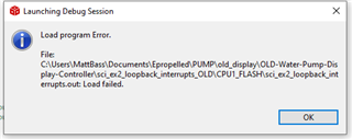

Hi there I am getting this error
whenever I am trying to flash my board. The file is there though and the code is building successfully so I am not sure what the problem is. Some help would be greatly appreciated, thanks!

Matthew,
Is this TI EVM or your custom board? Can you put the board in 'Wait Boot' mode and try to load again?

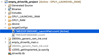

What are CCS version and C2000Ware Version?
Can you try one of the example from C2000Ware?
C:/ti/c2000/C2000Ware_4_01_00_00/driverlib/f28004x/examples/led
When you import the project, you need to use CPU1_LAUNCHXL_FLASH build configuration. Right-Click on the project, and then select Build Configuration -> SetActive. See fihure below.

You should update to the latest CCS and C2000Ware. However, please follow the steps I mentioned earlier, and it should work. Also please refer to C2000 Academy for detailed instruction.

Meanwhile, please try the instruction I mentioned before. Select the CPU1_LAUNCHXL_RAM or CPU1_LAUNCHXK_FLASH build configuration.
Also make sure, you have correct target configuration as active.
