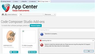

Can you please send me the package - Compiler: TI ARM C/C++ Compiler v5.1.6

Hello, thanks for very quick response. But my problem is: I get a connection error if I follow the steps you suggest.
I tried to change proxy settings and I tried the 3 options for direct/manual/native connection options. Waiting for your further help

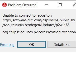

CCS 11.1.0 - Windows 10 - 21H2
Unable to connect to repository software-dl.ti.com/.../content.xml
Connect to software-dl.ti.com:80 [software-dl.ti.com/104.96.93.70] failed: Connection refused: connect
It appears that CCS is unable to access the internet.
One last check - when you try to check for available CCS updates, does it fail?
Ok, there are definitely issues with internet access for CCS.
I assume your PC itself has no issue with internet access and that the issue is specific to CCS.
Are you on a network that requires a proxy to access internet access? If so, please try configuring it as mentioned in:
https://software-dl.ti.com/ccs/esd/documents/ccs_updates.html#proxy-configuration (see chaper: "Proxy Configuration").
Typically you'd have set it to "manual" and then enter the valid information fro HTTP and HTTPS
Hello again, I tried 3 options for connection settings: Direct/Native/Manual but somehow it didn't work. In Native option it says:
HTTP Proxy Authentication Required: software-dl.ti.com/.../content.xml

You have "proxy" as the host. Is that correct for your netowrk?
