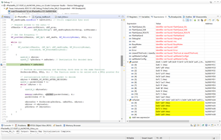

Hi team,
Here's an issue from the customer may need your help:
Referenced to DN504 FEC implementation, the customer FEC code the source data (0x01 0x02 0x03 0x04 0x05) with the following data: 4C F0 30 10 C8 7C C3 23 40 34 7C E3.
And referenced to DN507 FEC Decoding to decode the above encoded data and got the following data: 0x01 0x02 0x73 0x04 0x05, which is inconsistent with the source data.
// NUMBER_OF_BYTES_AFTER_DECODING should be given the length of the payload + CRC (CRC is optional)
#define NUMBER_OF_BYTES_AFTER_DECODING  5
#define NUMBER_OF_BYTES_BEFORE_DECODING (4 * ((NUMBER_OF_BYTES_AFTER_DECODING / 2) + 1))

		// Running here, the rxPacket contents are 01 02 73 04 05 (hex)

Could you help check this case? Thanks.
Cherry
  • Hi
    Did a test where I encoded and sent the data 0x01, 0x02, 0x03, 0x04, 0x05 using a CC1312, and received them using a CC1312R.
    I implemented the code described in the app notes, but re-wrote the part where the code referred to reading the FIFO, since the CC1312 does not have a FIFO.
    the packet was encoded and decoded correctly, and this was also verified by communicating with a CC1101 and SmartRF Studio (with FEC enabled):
    I used the CC1312R rfPacketRX example as a starting point. Please note that buffer sizes was optimized to only fit this particular packet (5 bytes payload, no CRC) resulting in 12 bytes of interleaved data.
    Modified code is below:

    The customer has run fecDecode on the CC1352P according to the code you provided, and it still got 0x01 0x02 0x73 0x04 0x05, which is not as expected.
    In the program, two places were modified:
    1) RF_runCmd() is masked;
    2) Forces the initial value of array packet to 0x4C, 0xF0, 0x30, 0x10, 0xC80x7C, 0xC3, 0x23, 0x40, 0x34,0x7C, 0xE3;
    The source code is as follows:

    Development Environment is as follows:
       1. Code Composer Studio Version: 9.2.0.00013
        2. SimpleLink CC13x2 26x2 SDK 3.20.0.68
        3. Compiler version: TI v18.12.3.LTS
    While the same code being ported to the MSP432P411R and get 0x01 0x02 0x03 0x04 0x05.
    Why? Configuration issues with project properties?
    Thanks and regards,
    Cherry
