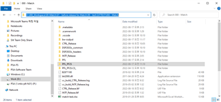

I am using CCS v8 and I try to rebuild by command line like "c:\ti\ccsv8\eclipse\eclipsec.exe", but there was a problem below. please advice me to overcome this issue.
1. My workspace folder
2. Source folder path
3. CCS v8 screen --> No problem with rebuild
4. command line command --> Is it correct command line
"c:\ti\ccsv8\eclipse\eclipsec.exe" -nosplash -data "C:\Users\kimkw\workspace_v8" -ccs.autoImport -application com.ti.ccstudio.apps.projectBuild -ccs.projects "D:\000_Workspace\00-Match\01 - before release for Match\99 - test\OJTTEST\000 - Match" -generateMakefiles -application com.ti.ccstudio.apps.projectBuild -ccs.configuration Release -ccs.projects utils

    Have you reviewed the following documentation?:
    https://software-dl.ti.com/ccs/esd/documents/ccs_projects-command-line.html
    One thing I noticed is that this may be wrong because I could not find such an option:
    -ccs.autoImport
    Maybe it should be:
    -application com.ti.ccstudio.apps.projectImport -ccs.location <path> -ccs.autoImportReferencedProjects
  • If the project is already in the workspace then something like this should be the correct command
    eclipsec -noSplash -data <full path to workspace> -application com.ti.ccstudio.apps.projectBuild -ccs.projects <project name> -ccs.configuration <build configuration name>
    Looking at your screen captures this is what I would try:
    eclipsec -noSplash -data "C:\Users\kimkw\workspace_v8" -application com.ti.ccstudio.apps.projectBuild -ccs.projects PFL_PF2S -ccs.configuration INTF_Release
