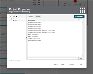

  • Hi Ki,
    I'm not able to import the projects with this account as discussed privately.
    In parallel, while it allowed importing the project with another TI account, it won't allow running the GUI, in the project ocnfiguraiton the development board can be connected successfully:
    However, if I hit the 'Play' button in the GUI composer, the development board is flashed but the verification fails:
    Find attached the log from GUI Composer:

  • I tried creating a new project, using the same target configuration and it was able to connect properly so I'm guessing it is related to a corrupted recovered project or some kind of issue during the import process.
    One known issue is that if variable binding are incorrect, it will cause a connection error even if the initial connection is successful. It is unusual for this to happen for a known working good project but perhaps something happened to the bindings when you imported to a new workspace.
  • This was the source of the issue. It would probably be a good idea to have this error reported by the GUI Composer when the connection fails.
