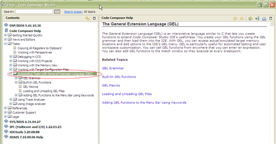

  • I'm using CCSV4.  I can't figure out how to see or do ANYTHING directly with GEL files.  The word GEL does not exist in any of the menus.  The help documentation has bad links for GEL details.  It's NOT at Tools / GEL...
    Please tell me or remind me where to access GEL files, load them, select them, or maintain them, from within CCSV4.  A link to some valid doc would be very nice as well!
    Thanks very much,
    Helmut
    Hi Helmut,
    GEL Documentation can be found in the included Help files ('Help->Help Contents'):
    See this wiki topic: http://processors.wiki.ti.com/index.php/GEL
    ki
  • Another good GEL doc on how they are used to auto-initialize a target when starting the debugger.
    http://focus.ti.com/lit/an/spraa74a/spraa74a.pdf
  • Thanks.  Neither search nor index revealed this help location, and contents navigation didn't show the word GEL at the end of the long line in a narrower window!  And I didn't notice the spelled out General Extension Language.
  • FYI, the "GEL Files" option does not appear on the Tools menu at all, not even grayed out, unless your target configuration is currently launched.
