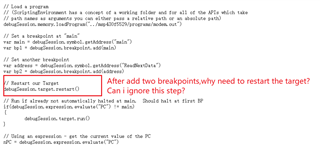

  • Yeah, that's what we do. We adjust the clock properties to auto-reset before each run.
  • Ok, yes then it should be the cycle count between the two breakpoints

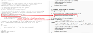

  • Hi Ki, I found the clock cycle count values obtained by two ways differ greatly on CCSIDE. The first way is connect target ,add  breakpoint before run target.The second way is connect target ,then let target run for a period of time,after that pause the target ,add breakpoint and run target again.Which way is more accurate? If I call run() API in the script to make the target run first, it is sad that target does not return control, so i can't pause it ,add breakpoint and run it again. it seems that i only  can call add.breakpoint() API firstly then call run() API , right?Should i call halt() API if i want pause the target when it is running and call run() API again after pause it?

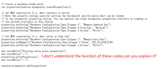

  • I read some official script examples about using APIs,  and i have some questions hope you can help me answer them. Thank very much!
    I can't quite tell the difference between the three API:
    debugSession.symbol.getAddress("ReadNextData")
    debugSession.memory.readRegister("PC")
    debugSession.expression.evaluate("PC")
    Three APIs all seem to be getting address value,What are the differences among address value obtained by three APIs?

  • I can't quite tell the difference between the three API:
    symbol.getAddress would get the address of a symbol (like a global variable, etc).
    memory.readRegister would return the value of a core or memory mapped register
    expression,evaluate - this one is a little complicated but it would try to return the value of an expression like a register or variable. I would not use this one if possible
    target.restart would simply reset the PC to the program entry point. Whether you want to do that or not would depend on you. I would assume you would not.
    properties.printProperties is to print out the available breakpoint properties. Please see the below link for more details:
    https://software-dl.ti.com/ccs/esd/documents/users_guide/sdto_dss_handbook.html#breakpoints

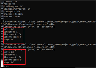

  •       Hi Ki, I review TestServe.js code of TestServe method,learn that if i  execute the "stop" command, the target will disconnect and session will  terminate, then the servw will shut down. That means i could run serve and connect target again if i want to continue to execute others commands. I tested according to my own understanding,I started the serve,connected target,loaded program,then ran the target,the target ran successfully.Then i executed the "stop" command,let the target disconnect and serve shut down.Wait for a while,I start the serev to open two session again,execute the "connect" command, feekback of execution tells me the target connect successfully, then i try to execute "halt" to halt program,but the result of execution is "fail" and "the target is already halt".I was puzzled by this result.I found the target actually halted by debugging.Why is target halt? I did not execute "halt" command. Is my own understanding wrong? Two days ago,I tested on CCS IDE,found that “connect” really can not stop the core sending message,only execute"halt" to halt the program and the core will stop sending message.
          Thanks for your reply.Best wish!
    Rui

  • t if i  execute the "stop" command, the target will disconnect and session will  terminate, then the servw will shut down.
    When I take a look at the stop command handler, it looks like:
    function stopCommandHandler(session, command) {
        /* This command is used to tell the session to stop taking connection from new clients.
           Any additional actions that needs to be done when a stop command is issued can be done here. */
        if (session.target.isConnected()) {
            try {
                session.target.disconnect();
            } catch (err) {
                return { "status": "FAIL", "message": "" + err};
        return { "status": "OK" };
    Basically all this does it disconnect the target. It doesn't shut the debug session down. That surprised me because I thought it did shut the debug session down like you suspected. The debug session is actually shutdown by the shutdown function in TestServer.js
    The default behavior of the debugger is to halt the target on target connect. CPUs that support real-time mode can be configured to not halt on connect. For a AWR1843, the R4 does not support real-time mode with the C674x does.
    ki

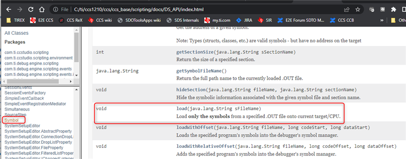

  • OK , I see. I find a function "load symbol" on CCS IDE,but it seems that I don't find this API on API document.Do you know which API is related with "load symbol"?Thanks
  • Sorry for the delayed response. I was on vacation for awhile and just returned.
    It is symbol.load
