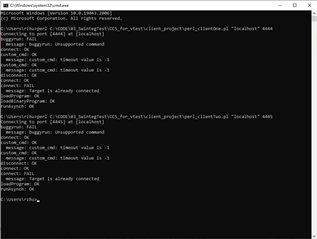

Hello KI, I am using AWR1843, XSD110 debugger and ccs software to build a debugging environment, and when I call the API to write a script to implement automated testing, I find that if I call the run() API, the target board can run successfully, the indicator light will flash, but the control will not be returned to the host application/script, and any operations following the run() command will not be executed, making the program unable to perform other operations. If the runAsynch() API is called, the control can be returned to the host application/script, and the operations after runAsynch() will be executed, but the AWR1843 target board will not be able to run successfully, the indicator light will not flash, if the timeout setting is added, it will display the target board fails to run, why is this? Is there any API that would allow the target board to run successfully, blink the lights and return control to the host application/script? The following are the execution results and script documentation, can you help? thank you very much!

  • , I find that if I call the run() API, the target board can run successfully, the indicator light will flash, but the control will not be returned to the host application/script, and any operations following the run() command will not be executed, making the program unable to perform other operations.
    Yes this is true... unless you set a timeout. Try setting a timeout of several seconds. That will force the run() API to timeout and return (note that the timeout will not impact the running target in any way). Does the program still run successfully?
  • KI, according to what you said, we set a timeout of a few seconds for the clients corresponding to the two cores (the timeout period set by the kernel that runs first is longer than that of the kernel that runs later), the AWR1843 target board can run successfully(if set the same time, the target board may not run), and the control right after the timeout expires will be returned, but the AWR1843 target board will stop running after the timeout throws an exception. I remember that you let us set up two cores as a group, call the run() API and set a timeout, in this case after the timeout returns control, the AWR1843 target board can still continue to run, and the flash will keep blinking. Why is this? Why the two cores are executed separately, and the target board stops flashing after the timeout? We want the AWR1843 target board to run, and the control can also be returned, but the board will not stop running, so that we can continue to run the next script and execute other command operations. Is there any way to solve it? Can you give a solution? Because this is related to our recent project, it is more urgent, I hope you can help us. There is a time difference between our two countries, is there any more effective way to communicate? For example, hold a meeting to discuss when we are all online, I think it may be more effective to communicate this way, what do you think, haha
    Thanks!
  • I have been investigating this further and I believe I can see the issue you are reporting. I have a simple program that blinks the LED. When I run it with runAsynch, the LED does blink. Also, when I run it with the "run" command, the LED will blink until the timeout. Then it will stop blinking. This is the behavior you witnessed also. This should not be the case. I then had similar actions in a standard dss javascript. runAsynch() works as expected (blinking the LED). Same with a run() call with a timeout.
    Hence there appears to be some issue with the TestServer environment. At first glance, I don't see what the issue could be. Even more curious is that I added a custom TestServer command that queries the target status to see if is is halted or not (using the isHalted() API). When I call the command, it returns that the target is NOT halted (even though the LED is not blinking). Hence is the target running incorrectly like you mentioned that you are seeing? Again I don't yet know.
    Support for the TestServer script is somewhat limited so it may take a bit of time to get to the bottom of this. My apologies for the issues.

    After setting the timeout yesterday, we called the run() API, and executed the breakpoint command after that. The console execution prints the result as follows. Does this mean that if the script is used to implement automated testing, when the AWR1843 board is running, it can't be interrupted, right? (To be precise, you can hit a hardware breakpoint, or stop the target board first and then hit a software breakpoint). But if the CCS software is used for manual operation, when the target board is running, both software breakpoints and hardware breakpoints can be hit. This is different from script testing. Why? If we automate the test with scripts, is there a limit to the types of breakpoints?
  • Does this mean that if the script is used to implement automated testing, when the AWR1843 board is running, it can't be interrupted, right?
    Most devices/cpus require the target be halted before a software breakpoint can be set. A software brekapoint is an intrusive step that writes a halt opcode to the memory location. A hardware breakpoint does not require a write to memory.
    Note that this is regarding setting a software brekapoint. Once the software breakpoint is set, a running target will get halted when a breakpoint (hw or sw) is hit.
    In regards to breakpoint limitation, that is determined by the device and debugger. Both are the same between scripting and CCS IDE.
    The error in your screenshot is regarding setting a software breakpoint. If you are saying that you are able to set breakpoints in the IDE while target is running but not in the script, then you may be setting hardware breakpoints in the IDE.

    This also works as expected with TestServer. I set up one for my AWR1642.Port 4444 is for the R4 and 4445 for the DSP.
    In the screenshots below you can see that for the R4, I could not set a breakpoint while the target is running. For the DSP, I was able to.

  • Yes, the information printed in our black window is the same as you. After calling the runAsynch() API, it returns OK, but the target board light does not flash.
  • ok, thank you very much, we are looking forward to your early reply.
  • After calling the runAsynch() API, it returns OK, but the target board light does not flash.
    Yes this is the mystery I need to investigate...
  • Yes this is the mystery I need to investigate...
    During my investigations, I can see that when a runAsynch is executed, the target runs for a short moment but then halts immediately after. It is similar to when a timeout occurs for the run command. I'm not sure what is triggering the halt, I'm investigating this now.
  • However, our target board will not run at all. When will this question be answered at the latest? Our project is advancing step by step, and integration testing is about to start, but the environment has not been set up yet.
  • I found the root cause of the issue.
    The TestServer script will halt the CPU before closing the connection with the client script. Hence why when you call runAsynch and then the client script finishes execution, the TestServer script will then halt the target before closing connection.
    It is not exactly a bug per se since it is explicitly mentioned in the script that this action is taking place. However I am wondering what the overall purpose of this is. Clearly it is an undesired behavior in cases where you want to leave the target running.
    In any case, you can work around the issue by commenting out line 207 in "TestServer.js":
    Thanks for yoru patience.

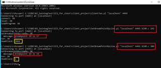

  • Hello,Ki, We tested it according to the method you said. After the first core connection calls the runAsynch() API, the control returns to the target board successfully and the light turns green. After the second core connection calls the runAsynch() API, the control is also returned, but the indicator light of the target board does not flash, why is this?
  • We try to add two breakpoints with one of the cores, and then call the runBenchmark() API to read the execution time between the two breakpoints, and get a return value of type long. What is the unit of this value? milliseconds or seconds? Is it just the execution time of the code or does it need to be calculated and converted to be the final time value? Our two perl script commands are as follows, please help to see if it is right, thank you!
    perl script one:
    $client->open();
    $cmd = {
    	"name" => "connect",
    execute_command($cmd);
    $cmd = {
    	"name" => "setBreakpointByLineNo",
    	"fileName" => "SCHM.c",
    	"lineNo" => "292",
    # Execute program.
    $cmd = {
    	"name" => "run",
    # We are done now.
    $client->close();
    perl script two:
    $client->open();
    $cmd = {
    	"lineNo" => "309",
    # Execute program.
    $cmd = {
    	"name" => "run",
    # Read clock.
    $cmd = {
    	"name" => "readClock",
    # We are done now.
    $client->close();

  • We tested it according to the method you said. After the first core connection calls the runAsynch() API, the control returns to the target board successfully and the light turns green.
    Great!
    I don't know the reason for this issue. But if you just do a regular run call for the second core, does it blink as expected?
  • What is the unit of this value? milliseconds or seconds? Is it just the execution time of the code or does it need to be calculated and converted to be the final time value?
    It is CPU cycles.
    See the section in the article below called: "Convert Cycles to actual time"

  • I see you created a command called "readClock". Can you describe what this command does? And where do you enable the clock?
  • The Read clock command is used to read the execution time of the code between two breakpoints. It calls the runBenchmark() API. Our execution sequence is: add breakpoint -> run target -> read clock, the script screenshot is as follows. The final execution result is that after adding the first breakpoint, the return clock cycle count is 1064; after adding the second breakpoint, the return clock cycle count is 1. This is not what we expected. We think that the clock cycle count value after the second breakpoint is added should be greater than the first return value, The value obtained by subtracting the two numbers is converted to the execution time of the code between the two breakpoints. Does the runBenchmark() API automatically clear the previous count before each count?
    Note that runBenchmark does the following:
    -enable and reset the profile clock
    -run the target
    -returns the cycle count when halted.
    Note that your perl script is sending a "run" command, followed by a "readClock" command. Esentially you are doing 2 consecutive runs, with only the cycle count of the secound run being returned.
    Is this what you want?
    yes it does. If you wish to not have the clock reset, then you should manually enable the clock, do a standard run, and then do a standard read the clock.

  • Hello Ki, long time no see, we recently re-try the function of clock reading code execution time between two breakpoints with a script, the value of clock cycle read by the script is very different from the clock cycle count we read manually on CCSIDE , our script execution result and script content are as follows, can you help us to check whether the script is correct? Is there any way to verify the correctness of the results obtained by executing the script?Thanks!
  • our script execution result and script content are as follows, can you help us to check whether the script is correct?
    I believe readClock is your custom command and it basically calls the DSS API "runBenchmark". Is that correct? If so, then your client script looks fine. I can't commend on your inmplementation of readClock command since you did not prove the source to that.
    Turn on IDE visibility while the server script is running. That way you can visually see what is happening while the scripts run:
    https://software-dl.ti.com/ccs/esd/documents/dss_launching_ccs_from_dss.html
    This is very useful for debugging scripts and I actually did this to find the cause of your original issue of why the target was halting after running runAsych
    You can add the line to launch the IDE in the "TestServer.js" script, in the TestServer function after the scritping instance is created.
    ki
  • Yeah,readClock is my custom command that basically calls the DSS API "runBenchmark". Are breakpoints added by add.breakpoint() API on script hardware breakpoints? So I need to remove the first breakpoint before adding the second one when starting the clock event. Later I retried removing the first breakpoint before adding the second one, and the value of the clock cycle looked much more normal. I'll try again tomorrow, as you said, thank you for your help.
  • Are breakpoints added by add.breakpoint() API on script hardware breakpoints?
    It will, assuming the debugging memory map is configured properly. You would get a failure message if it was not.
    Remember that runBenchmark will simply run to the next breakpoint and return the cycte count. Modify your script so that you read the PC before you call readClock and then after so that you know you counted the cycles from the correct addresses. I don't think there is a test server command to the read a register, you'll need to implement it using DSS.
  • What is PC? computer? I remember the official documentation saying that hardware breakpoint can only be added one at a time when the clock event is turned on. We manually debug on CCSIDE when the clock event is turned on,after the target stops at the breakpoint, we will remove the breakpoint, re-add the second breakpoint, and then run the target board again, when the target board stops at the second breakpoint, the clock cycle count read is the clock cycle between the two breakpoints, is that so? If that's the case, as I understand it, when I add a breakpoint on the script and call the runBenchmark API, the target board runs and stops at the breakpoint I added, right? Or does the target board stops at the breakpoint before I call the runBenchmark API?
  • What is PC?
    The Program Counter. It is a register that has the addess of the current location of the program counter. You can see it in the Register view
    This depends on the device since the profile clock will use a hardware breakpoint resource. Some devices (like older C2000 devices) only have two resources. Other devices/CPUs may have more. There should be more than two on C6000 and ARM.
    Note that the inside the CCSIDE, the profile clock will keep a cumulative count by default. It does not reset between runs. So if the clock is enabled and then run to a breakpoint, the profile clock will store the cycle count from when it was enabled to when it hit that first breakpoint. So then if you set your second breakpoint and run to it, it will ADD the value of the cycle count between breakpoints AND the original value from when the clock was enabled to the first breakpoint. The clock can be reset by double-clicking on it. You can also adjust the clock properties to auto-reset before each run. The the default behavior is to keep a cumulative count.
