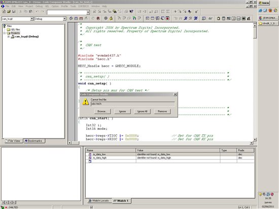

Hi. I have got DM6437 DVDP and I have some problems: I probe demo6437_demo program (executed on start) and I can’t connect hostapp with device. I know the device is running because audio line in is on audio line out (with SW4-3 down). The 4 LEDs are off (even DS1, with both SW7 position). “Getting started Guide” document describes that DS2 LED might be ON when the IPstack is ready. By default, demo is configurated in DHCP mode, so I connect board to a router whit DHCP activated, and through my computer host (where I try to connect with “hostapp”). I check connections in router and I find 192.168.1.105 to client host “dm6437evm9def” and 192.168.1.106 for the host. I think all is correct, by it happens three troubles: 1. I can’t do ping from host to board (from 192.168.1.106 to 192.168.1.105) 2. LED DS2 is off 3. hostapp can’t connect to board (both button “discover” and connect to 192.168.1.105 )

    Thanks.  I knew this file (std.h) is in that path, but is strange that message (a popup appears  in CCS opening dm6430_demo_1_30_00 project, saying "Cannot find xdc/std.h") without compiling. After compiling, compiler says fails in opening this file too. I suppose it's necesary change something in some paths or files to associate this file with the path that you say. I checked I have too in this path...

  • Well. I check some posts and I find some possibilities to fix my problem.
    I had two installation for BIOS (5.31.02 & 5.31.07), and demo6437 compiles with 07. For that, I desintalled 02 version and changed enviroment variable to 07 version in my host.
    I checked  "component manager"  in CCS3.3 ( 3.3.38.2), and associated BIOS 5.31.07. The information is Code generation v6.0.8 Board revision 0.0.0 , target revision 0.0.0, adn correct BIOS
    I checked in "C:\dvsdk_1_01_00_15" two xdc files: C:\dvsdk_1_01_00_15: xdcpaths (mak file) and xdcpaths_evmDM6437 (data file) (I don't know what to do now, and I don't know how this files affect the CCS enviromentment. )
    I realized that in xdcpaths there was incorrect path for XDC_PATH entry XDC_INSTALL_DIR   := $(DAVINCI6437_INSTALL_DIR)/xdc_2_91_02 and I had xdc_2_95_02, for that I changed it.
    The problem is present yet, the enviroment don't find std file.

  • Finally I could compiled it!!!
    But, I  load .out program (in Debug directory) and it's not working fine: there is no image in ouput and if I put break point in first line of void main, never reaches that!
    int main(int argc, char *argv[]) {
      int status = 0;
      /* init the codec engine runtime */
      CERuntime_init();   <----- HERE
    Does anyone know what it happens? Maybe project is different that in flash is loaded...

  • I use CCS 3.3.38.2 updated (checked from available updates TI site).I use DM6437
    I have a lot of problems with every projects using BIOS/PSP. I can't debug this projects, and I have doubts programs are executing correctly. Only test examples(included in CCS/boards/DM6437 folder) work.
    I followed steps in "C6000 Embedded Design Workshop Using BIOS" (all files downloaded) and I could create a project with BIOS to process audio-in and give it on output. In this case, I can debug. I understand GUI and utilities/tools.
    But I need processing video from one camera and give it in output DAC (this workshop uses audio codec only). I found "Accessing_Pixels_In_A_Frame_1_03"  based in "video_preview" doing that, but I can't debug.  I recompile "video_preview" and there's no troubles, I load it and it runs (CCS tells me "running"), but I can't  "go to main", stopping in breakpoints (SW/HW). I see video camera in output,  but I think the program loaded in flash (default program) is executing and not RAM downloaded program ...
    I think examples/samples in dm6437 folder (dvsdk_1_01_00_15) doesn't work. PSP examples in same folder don't work too.
    How can I resolve this problems?? have anyone programs/tutorial to doing video processing with BIOS/PSP??

    Welle, finally I found the solution thanks to  "Sankaranarayanan B" in DSPRelated Forum. I resolved my problems: I should changing GEL file, downloaded from Digital Spectrum web, and then, all projects ran fine.

  • Yes, of course. The link with GEL file it works fine in my EVM is:
    http://c6000.spectrumdigital.com/evmdm6437/reve/files/evmdm6437.gel
