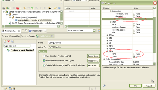

  • Hello Maria,
    Maria Lucas said:
    Could the profiler provide the average number of instructions executed per clock cycle?
    Not quite. But you can get the total number of executed instructions and the total cycles. From that, you can determine the average number of instructions executed per cycle.
    ki
  • Thank you very much. All your answers are very useful for me.
  • Dear Ki-Soo Lee,
    Thank you very much for your help. I have configured and I have run my program, and now I can see the number of instructions executed. However, I have a doubt. The number of executed instructions is smaller than the number of elapsed clock cycles for each function. If each functional unit is able to execute an instruction per clock cycle, the number of executed instructions should be higher than the number el elapsed clock cycles, shouldn't it? Is this result normal?
