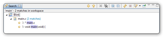

In v4 it doesn't give you a lot of details in the search results
CCSv5 will give you more details

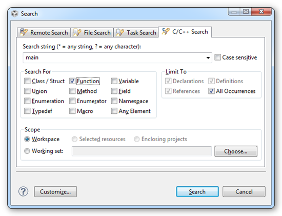

It will also allow you to do different types of searches, where v4 only allows a file search you can do a C/C++ based search in v5.
Here I am selecting to only show me hits in function names:
By selecting the view menu, circled in red I can also change it from a tree view to a list. You can select the list in v4 as well but it doesn't organize it very well.
