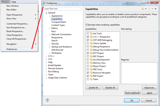

  • Martin -
    I have no Window-Preferences/General/Capabilities item so can't select anything.

  • You should have the way of adjusting capabilities see picture below.
    Regarding your project: unfortunately, it looks like your project was created using that GNU ARM eclipse plugin, which does not seem to work for me in CCSv5.1 (at least I can't create new projects when that plugin is installed). The "no base extension for..." provided the necessary information.  org.eclipse.cdt.cross.arm.gnu... is the internal plugin name for GNU ARM Eclipse plugin. You do not have it installed in 5.1 hence the error message.
