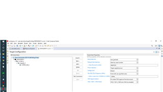

I am trying to program MSP432e401y launchpad using XDS110 Debug probe using 20 PIn to 10 PIn cable convertor which is provided by TI. CCS show me "The value is '-233' (0xffffff17). The title is 'SC_ERR_PATH_BROKEN'." Please find attachment to detail understand
Could you suggest me how to program it using debugger.
  • Your Target Configuration file shows Debug Probe Selection as "Select by serial number" with a Serial number of "ME401023". I think that serial number could be for the onboard XDS110 on the launchpad, which is disconnected from the target, rather than for the TMDSEMU110-U.
    I tried the same configuration, with the launchpad USB connection powered from the same PC as the TMDSEMU110-U. Plugging one in at a time caused xdsdfu  -e to show:
    • The launchpad XDS110 serial number was ME401023
    • The TMDSEMU110-U serial number was 00000000
    If I use "Select by serial number" with a Serial number of "ME401023" (the launchpad) then a test connection fails with 'SC_ERR_PATH_BROKEN'.
    Whereas if use "Select by serial number" with a Serial number of "00000000" (the TMDSEMU110-U) then the test connection passes:

  • Thank you Chester, This is solved my problem.
