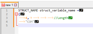

Hi Folks,
i have an uncritical but quite annoying problem using Code Composer Studio 12 (CCS 12.0.0.00009): I cant get CCS to use tabs instead of spaces before comments....
It should look like this:
STRUCT_NAME struct_variable_name =
	4,				//Length
	"COM",			//Command
	"?",			//Command type
Instead CCS makes this:
{ 4,   //Length
        "COM",   //Command
        "?",   //Command type
Ignoring that i dont find the option for the new line for the first element, CCS changes the tabs into spaces. I tried to google it and found some hints but it wont work! I set Preferences->C/C++ ->CodeStyle -> Formatter -> Indentation to "Tabs only" and "use tabs only for leading...". Also under Formatter-> Comments i disabled "preserve white spaces between code and line comments..." .
What am i missing? I see a lot of post and settings to "force space" but i want to “force tab". Even when there are only tabs like in the first code example it changes them to spaces.
Thanks for your help and best wishes
Tobias
PS.: I hope the inserted code preserves invisible characters.

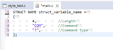

  • I'm unsure what is happening. When turning on the option to display hidden characters in the editor, i can see that tabs are being used instead of spaces.
    Can you export your preferences to a file (File -> Export -> General -Preferences) and attach it to this thread along with the source file in question?
    ki

  • Dear Ki,
    thanks for your reply - sure, i hope it worked (i couldnt upload the file you wanted, so changed the type to txt) .
    Hmm i have the option turned on and he uses spaces and tabs......... strange (but its eclipse ;) ).
    Best wishes
    Tobias

     * style_test.c
     *  Created on: 20.10.2022
     *      Author: Stein
    const PROGRAMDATA programdata_definition =
    { 4, "PRG",			// Telegrammkopf
             "?",     // Kommandokennung '?': dies ist eine Anfrage

  • Dear Kier,
    hmm you might have a point.... i have a lot of comments (a lot of time one each line) but character length each line varies slightly. I hoped that with the right automatic styling options i get a more even comment-experience and dont need to fine tune it each time i add or remove a single character in a line. Perhaps my intent resulted in the wrong direction i perused?
    Best wishes
    Tobias
  • Dear Tobias,
    OK so your objective is to keep comment alignment (with other comments) when you change the line of code before the comment? And that your method, at the moment, is to use tabs as a buffer between end-of-statement and beginning-of-comment?
    If so, I see your point, that would be desirable. However I think using tabs to solve the problem may not be worth the hassle in the long run.
    I noticed that Notepad++ has exactly the behaviour you want but I doubt that's a practical solution for you.
  • Tobias - thank you, I got the files. I believe I see the issue now. I'll need to investigate further and I'll let you know when I find something
  • Kier,
    I tjust took a peek at how Notepad++ operates but I see the same behavior as CCS. Was there some option you enabled?
    ki
  • Hello Ki,
    All I did was enable Tabs, set the language to 'C', show whitespace then started typing the same code as the first snippet.
    I always get tabs giving the same content of the second snippet:
    As far as I understand, that's the formatting Tobias needs but have I misunderstood the problem?
  • Using the formatter settings from Tobias, I see tabs used:
