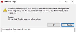

TI ARMCL compiler 5.1.3 and later versions support a "--no_stm" compile option that prevents generation of STMxx instructions for any writes to memory. One of my customers likes to know:
1. Is this option still supported by the latest ARMCL compilers? for exemple TI v20.2.x. After I added --no_stm option to compiler built flags, I got this warning message. Is this message expected?
2. When --no_stm is used, "no_stm_memcpy" and "no_stm_memset" will be called for memcpy and memset C/C++ functions. Does this mean that only memcpy and memset functions generate STMxx instructions? Is STMxx generated by any other C/C++ functions?
3. The customer said they saw issue when using LDMxx instructions. Is there any way to prevent the ARMCL compiler from generating LDMxx instructions?
  • Is this option still supported by the latest ARMCL compilers?
    Yes
    The warning issued by CCS is expected.
    No
    Yes.  But only to preserve registers on the stack.  If the stack is allocated to internal memory, there will be no problems.
    No
