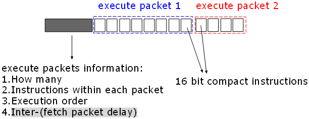

However, for whatever reason that the fetch packet is divided into execute packets, the information about
1. Execute packets, and the instructions they contain
2. The order of execution for different execute packets
3. The number of delay cycles between execute packet i and packet i+1
must be somehow encoded and placed somewhere in the fetch packet. How is this done and where is it placed?
Furthermore, does the compiler put instructions belong to each execute packets contiguously, or are they allowed to be scattered among other instructions? It seems to me that if they are placed contiguously, the information encoding should be easier, and requires fewer bits to encode.
And are execute packets placed in fetch packets according to their execution order? If the compiler does this work, it might also save several bits that would otherwise be needed to encode this information, as well as making the hardware logic less complicated.

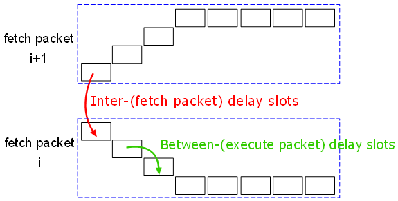

Not only could there be order of execution for different execute packets within a single fetch packets, but there could also be necessary delay cycles between
(1). The last execute packet of fetch packet i
(2). The first execute packet of fetch packet i+1
The reasons for this could be that
1. There are interdependency between at least one instruction in (2) and at least one instruction in (1).
and
2. (1)’s writing into register doesn’t immediately become available and requires one or more cycles’ delay.
When this happens, it is imperative that the necessary delay cycles be encoded somewhere into fetch packet i+1. Does the compiler actually do this? How is this encoded and where is it stored in the fetch packet?
Question 3:
How many instructions there are in a single VLIW fetch packet?
Each fetch packet is 8 words long containing 256 bits. Most instructions have standard 32 bit version, and many also have compact 16 bit version. If all bits are utilized, each fetch packet could contain 256/16=16 instruction. Considering the fact that some bits are needed to encode which instructions belong to which execute packet(s) as well as the execution order (see question 1 and 2), there should still be at least over 192 bits available (a rough lower bound estimate), allowing a maximum of 192/16=12 instructions.
If there are 12 (>8) instructions in the fetch packet, certainly they cannot be dispatched at the same cycle. Therefore, even if there are no interdependencies at all between instructions, they still needed to be dispatched in more than one cycles.
Does this really happen?
Where can I find the information on VLIW instruction structure? Which parts does it consist of? How does compiler generate them?

    Question 2:
    and
    2.    (1)'s writing into register doesn't immediately become available and requires one or more cycles' delay.
